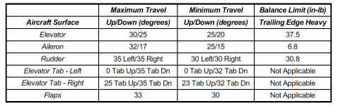

What have folks done about balancing the elevators after paint?
The issue is that the counter weights are though bolted and there is no way to remove them to add more weight.
Has anyone added more weight after paint, and how did you do it?

I talked to Vans this morning on this subject, specifically for the RV-10.
Summary of conversation:
Balancing after paint is a good idea.
Balance elevators individually. Balancing together should be ok, too.
For those who have not installed their tips, add a couple of nut plates just aft of the stock lead weights.
For those who have already attached tips, determine weight required, match drill 4 or 5 holes in the counter balance rib, and rivet the required weight using blind rivets. (Like Dan H's photo)
Balance within the limits in the following chart, for the RV-10.
There you have it...

I am wondering how one determines the in/lb?
I used a small plastic cup and put it where the weight will go and kept adding weight till it was balanced. Then weighed the plastic cup with its content which typically was about 5-6 oz and converted that to a piece of lead and mounted to a previously installed nutplates.

Bob,
Are these balance limits already in the RV-10 plans/construction manual, or is this new information from Van's?
Thx,
Bob,
Thx,
They are in the "Final Inspection and Flight Test" section of the main manual, so not new info.
That said, I probably would have put them in the Elevator section of the plans...
