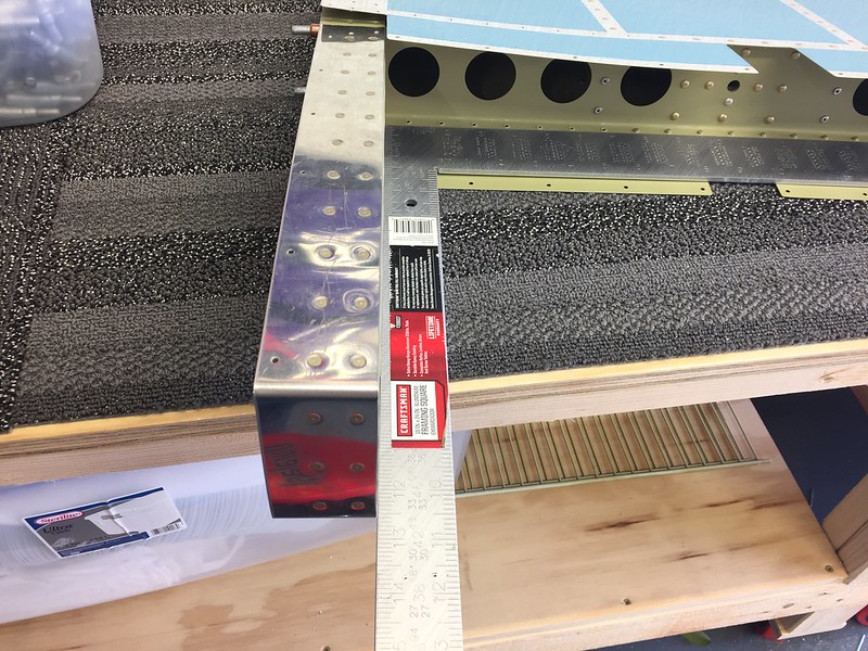

I then drew a line between a set of inboard rivets and set of outboard rivets on both the elevator and the HS. This gives me a method to measure the distance between the gaps. If the distance is equal then they're parallel. Looks like this;
After tinkering with both sides I was able to get an even 1.5 inches between the rivets both inboard and outboard... so parallel I believe.
* There are still uneven gaps on between the HS ends and the counterweight arms. Can this be fixed?
So the end result of having both elevators on and spaced an evenly across the board with 1.5" between rivet lines still ends up with an uneven gap on the arms.
Left side is 1/8" aft and 1/4" at the tip of the arm.
right side is 1/8 aft and 5/16 far forward
Any help on this would be appreciated, going to now see what rivets I need to order with my new Horn pieces.
