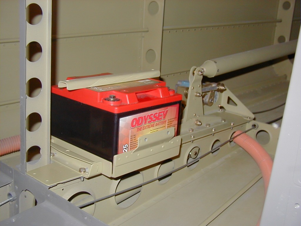

I'm in the throes of making decisions on the electrical system. I'm considering an Odyssey 925 battery, what would you suggest as a backup and do you have any photos of that setup (bracket, mount, etc). The electrical system of the plane will include a 70 amp Plane Power and an SD-20. Other items under consideration, Essential bus? Architecture? (We're installing a Garmin G900), etc, etc. Feel free to shoot me some wiring plans if you have something similar so I can noodle through them.
Here is William Curtis' 925 mount
Or Tim Olson's

Thanks for bringing us back around John, I am not hung up on having a backup battery, I wanted a 925 so I can have more juice. I'm not against having a backup battery, but I don't want to run another big honkin ground cable all the way forward to the single point firewall ground (I'm already running one 2ga cable up there). The other consideration of the PC925 is that I think it fits in the stock Van's battery box (on its side) with little to no modification. I'll do a little more investigating, then probably will just go with the PC925, they're 150 bucks locally.
The ground cable is not needed.
Just make sure you have good engine to airframe ground for the starter load, and it is a good idea to have a single point ground for the avionics that ties to the airframe, such as one of these from B and C.
I ve already got that single point ground (on both RV's), but in my experience, I always grounded the negative battery cable to it to avoid electrogremlins like strobe pops and "cable quality" music in the intercom system. I have flown in a 10 that had strobe pops and its battery was grounded locally instead of to the single point ground, so it's a 10 ton (actually 10 pound) gorilla I'm going to put up with. Can I run a backup battery without running two ground cables, ie, an intertie in the back with only one ground cable running fwd?
Yep, just hook both neg terminals together.-----
