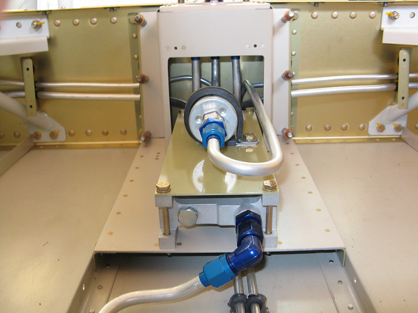

Thanks to all who have added to the discussion. As a follow-up, here's how I did it.
A few things to add:
- I have two negative leads; one to the housing and another to be grounded at a undetermined location.
- I threaded the bolts into the aluminum housing and secured with a star washer. Considering safety wire, but haven't gone that way yet. Or maybe I'll wick some thread lock there once I know I'm not pulling it apart anymore.
- Seemed like a good place to try wire lacing for the first time. Following the EAA video, it was pretty easy.
- Yes, I know by using those hand-shake connectors I'm introducing an additional failure point; but I think the advantage of wiring it on the bench outweighs the negative.
- The fuel filter will be mounted to the top-plate with an adel clamp.
- The line will run from the fuel valve forward through the filter then 180 into the pump. After pressurizing the flow aft, it'll once again 180 to run into the flow sensor. I chose this route so that I'll a nice straight shot into the fuel sensor and hopefully mitigate the fluctuation problem.
- Before torque sealing the fittings, I pulled them, added some fuel lube and then reinstalled.

Bruce,
Are you concerned about the pressure on those tabs? If I had gone that way, I think it would have added a tubing spacer to carry the load from the nut to the bolt head without putting undue pressure on the housing. Sure wouldn't want that to crack.
Also, where did you get an adel clamp that big?
Thanks for the help. If anyone notices anything amiss, please let me know.

Bruce,
Those tabs/ears are pretty beefy. In addition, the entire pump assembly is sandwiched between a bottom and top plate that spreads the load. The torque on an AN3 bolt is probably not going to add enough pressure on the housing to cause me concern.
I did not get the adel clamp from Robert. I bought one from my local industrial supply store (Marshall's Hardware in San Diego). It is an electrical conduit clamp.
I didn't get one either...thanks for the note. I'll look around.
