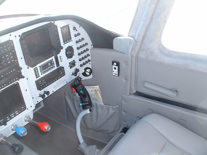

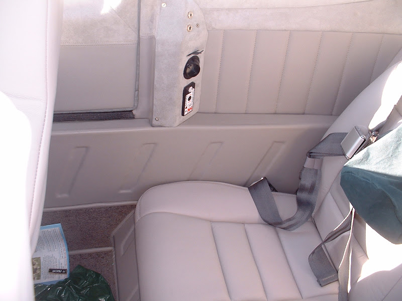

I'm trying to plan out the wiring and plumbing for my RV-10. I am installing a Mountain High EDS-4ip system for O2. I am putting an overhead console in the cabin. I have considered mounting the distribution units in the overhead console, but I am a little concerned about my ability to service those units if they're mounted in there. I have also considered putting the front seat units in the panel (near where the headphone jacks will go), and the rear seat units in the armrest area.
For those who have installed this O2 system, where have you located the distribution units? Pictures would be helpful.

Wayne Edgerton has the best mounted positions I have seen and I followed suit...contact me (PM) with your email address and I'll forward on the photos unless somebody beats me to it and uses the picassa route..I never can remember my logon to do that. I planned on doing the overhead thing but wasn't worth the effort after seeing his install. Deem Davis did install his in the overhead but it's a manifold needle valve system, not the Mt. High pulse demand baro sensing setup...which, by the way I find very trick and I'll let everyone know after I use it if it's worth the $$$ but all who have one says it is.

Pics from Rick
Rick sent me these pictures. Since he said he didn't remember his Picasa login, I'll post them to share with the group.
