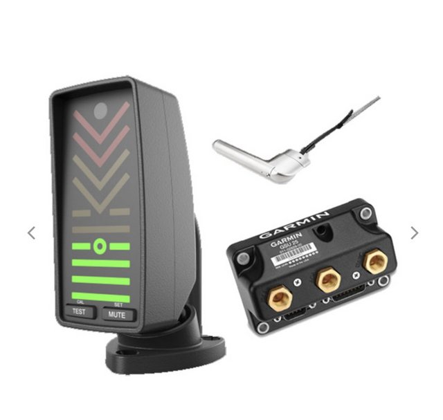

Stand Alone AOA
Amir,

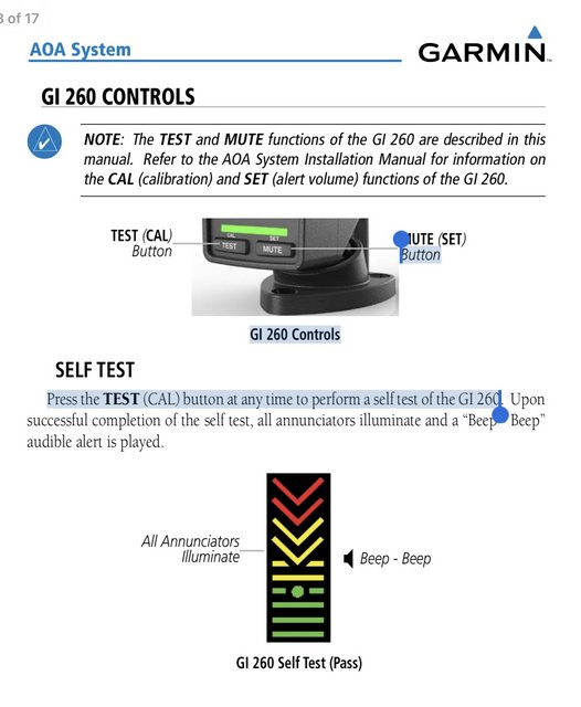

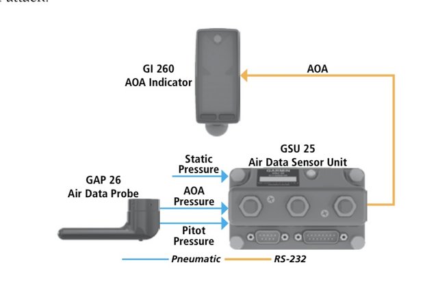

I just did this with my RV-8 and researched a couple options. The Garmin GAP 26 kit may work for you or if you want a bit of “do it yourself work” you can opt for the FlyOnSpeed system (https://www.flyonspeed.org/gen-2). The installation of the Flyonspeed system seemed a bit too complicated for me but you may have more experience in this area.
I have an Advanced Flight Systems EFIS so it was a no brainier to just replace my heated pitot tube with a Dynon heated pitot/AOA probe with controller. I did have to run a separate AOA tube back to the Adhars but it wasn’t difficult, just required a bit of grunt work to remove the lower left wing panels, the left side wing/fuselage fairing for access and of course some of the floors in the cockpit to get the line back to the ADHARS behind the aft baggage compartment.
In your case a Garmin GAP-26 heated AOA system may offer you an easier acceptable solution. Even though Aircraft Spruce says that this cannot be used as a stand alone system this is incorrect according to Garmin. I contacted them directly and they stated that it can be installed and used as a separate AOA system with the GI-260 externally mounted display. According to my e-mails with Garmin, the calibration does not have to be done on the G3X, it can be done directly on the GI-260 display using the Test button. G3Expert can chime in here but all the online data indicates that you have to have the G3X but evidently that is not true.
You will need the pitot mast to mount the probe so hopefully you already have one of those on the wing. The GI 260 display receives AOA input from a GSU 25 air data computer connected to a GAP 26 probe so you will need these plus associated tubing and fittings and of course a pitot mast to mount the probe on the bottom of the wing. This is not a cheap setup at around $1700 but would be a very capable and professional solution. I’ve flown a buddy’s RV-8 with the external GI-260 display (but he also has the G3X) and the display worked perfectly. He had his display offset to the left to stay out of direct view on approach but easily seen. I ended up just listening to the tones anyway and really liked the system. Picture below shows the AOA on the left side of the glare shield but he wired his so it is also displayed in the EFIS as well.

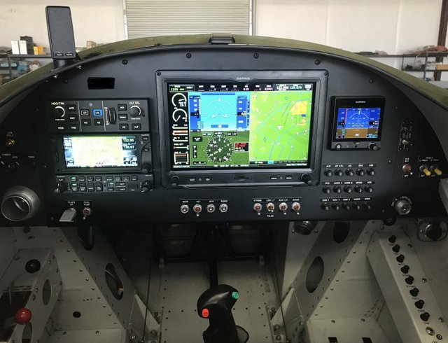

Thank you for this! I have a panel update sitting in my closet with two G5s so a 30 might not fit the bill, however, this got me looking into AV20s which are inexpensive and also have the AOA option. Going to dig in to how functional it is for that.

If you already have a G5 in your closet why not install it?

From my understanding, I don’t think the G5 supports AOA?

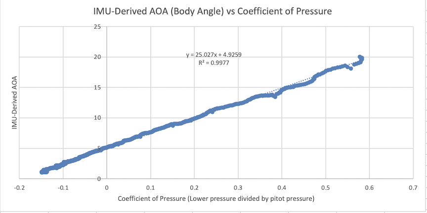

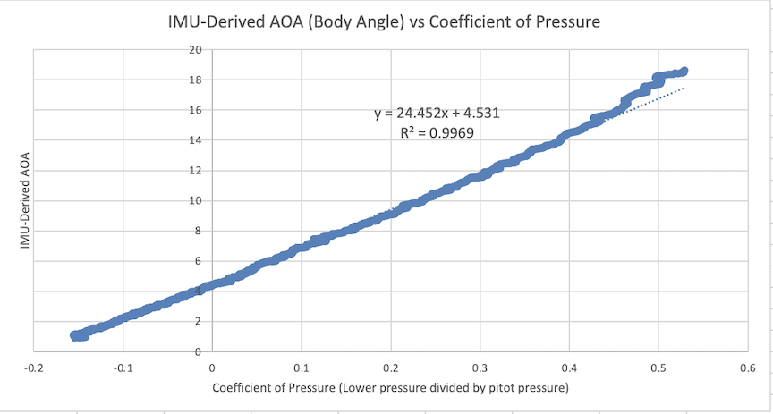

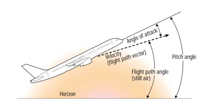

Applying Derived AOA
Since Amir decided to go with a system using derived AOA, let’s take a short look at what that is…
It means AOA derived by an inertial measurement unit (IMU). If the IMU can compute pitch and flight path angle, the difference between the two is AOA (technically “body angle,” but close enough for what we are trying to accomplish). It’s easy to picture this in level flight as shown in this diagram:

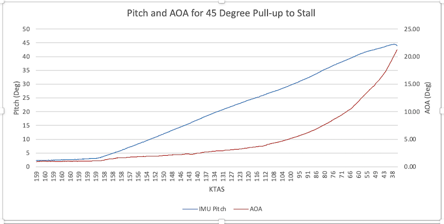

Things get more complicated as the airplane maneuvers or encounters rough air, as Paul points out. The processing power required to compute a tight attitude solution and flight path goes up; and good code is required that can handle the matrix calculus and Kalman filtering required. With the right IMU, processor and software, an accurate all-attitude, high-G capable derived AOA is in the art of the doable.
We currently use derived AOA to calibrate the ONSPEED system. This is a more primitive use of the capability but illustrates how it works using the relationships shown in the picture above. Our current processor doesn’t have the muscle to run advanced derived AOA code and keep up with all of the other functions required for flight test…
A calibration run consists of a deceleration from Vmax (as fast as the airplane will go in level flight) to stall. The IMU computes pitch and flight path angle and compares that to the coefficient of pressure as the airplane slows down and AOA increases. “Coefficient of pressure” is just a fancy way of saying one pressure divided by the other one (or using a geometric function to compare the two). This captures AOA for the entire speed range of the airplane very accurately. When you plot this out, it looks like this:
What’s neat about the physics is that the relationship between AOA the coefficient of pressure is nearly linear as AOA increases. When we take those hundreds or thousands of data points (depending on the clock speed the system is running, this plot shows 50 data points per second), it’s easy for the computer to condense all those points into a simple equation that can then be used to compute AOA from pressure data.
Some folks have pointed out that AOA is non-linear as stall is approached. This is correct, but we can demonstrate that it doesn’t matter to the AOA system. Here is a simple, wing’s level pull from level flight to a stall about 40 degrees nose up. The plot shows pitch (blue line) and AOA (red line). Note that even though the pitch input is linear (constant over time) the AOA increases in the shape of a parabola (increasing over time). That should remind you of the shape of the left side of the flight envelope :).
If we compare IMU-derived AOA with coefficient of pressure for this more extreme example, the relationship is still linear:
In a perfect world, the AOA system would compare IMU derived AOA with pressure derived AOA and warn the pilot when the two disagree. We're working on that.
Cheers,
Vac
