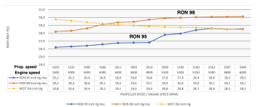

In your numbers it appears that with the eProp manifold pressures are higher for similar RPM. Is this a safe variance long-term for the 912 engine? It seems that it must be or the FADEC wouldn't allow.
The higher MAP seems to be ok, and is something I'm encouraged to see verified in this exercise. We can refer to SL-912-016 for guidance on MAP/RPM, at least with respect to detonation which would be the primary concern here.
I'd like to see MAP for the climb portions if available.
Worst by data review appeared to be 29.5 MP at 5182 RPM for last test flight using 93 octane ethanol free unleaded immediately after lift off (RON98) so I think we are good. I tried to keep RPM above 5200 which made airspeed to above 90 knots. I'd like to drop that down to closer to 70 at 5200 if possible.
