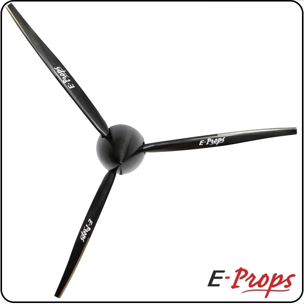

Has anyone looked into this prop from France? It's fully carbon fiber and uses a hybrid electric/hydraulic governor for simplicity and weight savings. The whole thing weighs in at under 9lbs, which is slightly less than the 3-blade prop sold with the kit.
https://www.youtube.com/watch?v=wPmRlwVYw4c
The constant speed model has only been out for a few months, but based on testimonials on their website it looks like several RV12's are flying with their fixed pitch props with great results.
https://aircraft.e-props.fr/index.php?cPath=1_21_1453
I was leaning towards the Airmaster, but struggling with adding 10lbs to the nose of the plane and having to either move the battery way aft or carry ballast.....this prop looks to completely solve that issue.
Innovation rocks.....Hopefully they'll get a bunch flying by the time I need one.

The fixed-pitch version is giving very good results
I cannot comment on the variable-pitch e-prop as I haven´t seen it installed on any plane near here yet but for the last 4-5 years I have several friends that have been trying the fixed-pitch version and they are all happy with the results. The prop is much lighter than the ones used before, people often say they feel a performance increase, both in take-off and cruise and the leading edge is quite resilient to gravel airstrips. Over here in Spain I´ve seen them installed in Tecnams, Pipistrels and Alto's, all with good results. I will probably move to the fixed-pitch e-prop once the time comes to change the Vans supplied prop, although first I have to finish building my -12.
The variable-pitch one will probably have better performance but for a -12 I rather go for less moving parts, less things that can go wrong.

Since the RV 12 climbs real good, I wouldn't add the complexity and money of a constant speed prop. But the french props are quite good. I have a DUC Swirl 3blade on my RV12iS and the performance seems good so far (7 hours) Both, DUC and E-PROP claim they have "constant speed effect". I can confirm this from personal experience. I see 5300 upm at 75kt climbing +1300ft and 5600 upm in WOT at 3500ft 123kts IAS.

We just installed the e-Prop on our 2015 RV-12 as it was showing its age with around 800 hours TTSN. Below is a link to the install with Evolution Trikes in KZPH. Total cost was $2,550 from Larry at Evolution Aircraft and install was just $100. E-prop includes everything for the pass through pitot spinner setup specific to the RV-12. He is a pro at installing, but you can DIY as the instructions are clear and the below video explains things. We were not compensated in any form. Have only flown the plane back to base since the install but the vibrations are significantly reduced from the 2-blade Sensenich. Performance numbers are still forthcoming but saw 110 TAS vs. 102 TAS at 5,300 RPM at 3,000' MSL.

Not an RV owner, but I lurk here because of the general high quality of the discussions. I have the E-Props on both my Flight Design CTSW and my Rans S-7S with Rotax 912ULS. i am happy with it in both cases. On the FD, I replaced the original prop. On the S-7S I started with the E-Props. I don't have hard figures on performance increases - I will say I'm very confident the E-Props is better than the original. I have a friend with a DUC on the Dynamik and he is happy with that prop. Mine are both ground adjustable.

I have a good friend who keeps his Just Highlander in my hangar and he decided to buy one and take the risk since they offer a 6 month try it you will like it return policy. He send the money and had the complete prop in just under 30 days. I helped him install and test it. It is very impressive as to completeness and quality. Very confidence inspiring.
It comes with all the special tools to install it and they are professional tools, not Chinese stuff. A VERY complete kit for the Rotax 912ULS. He has the big bore kit, ergo, 115 hp. We had it out of the box, installed, wired and running in less than a day. Testing was eye-opening. You can dial in the speed and it goes there and holds it. For instance we did static pull tests on the DUC Flash 3 blade system he did have and got 250 lb at WOT and about 5500 rpm. THen later in the day tested the E-prop at the highest engine RPM (about 5670 is all it could get at the lowest pitch static) and WOT and got 375 lb!!!!!!!!!!!!!!!!!!. Climb rate at 5750 rpm at 8000' was still over 750 fpm which is much better than the 250 or so with the fixed pitch DUC.

I finally installed the prop today. I ordered my prop last year but was not content with the spinner/pitot tube. There was a wobble in the spinner. The communication with e-props is very good and they have sent me a revised pitot setup/spinner. The pitot tube is now a carbon tube. Gap spinner / cowling is just 1/8" with the -15mm hub.
Initial data;
Old prop static rpm 5100, at 1000'/5000rpm 107kts. WOT 2500' 5750 rpm 115kts IAS, rate of climb average 1050fpm
New prop static rpm 5400, at 1000'/5000rpm 115kts IAS 5000RPM.WOT 2500' 127kts. rate of climb average 1200fpm
Weight was around 1130lbs. No GPS speeds checks done.
The prop is extremely smooth, no vibration at all while my Sensenich prop always had some light vibration even after a dynamic balance.
The sound is somewhat different, more high pitch

Update after second flight;
This time max tak-off weight. Looks like the take-off roll is somewhat shorter. Climb rate about the same as the Sensenich. Cruisespeed is still around 10kts higher at all altitudes.
At 1000' and 5000RPM 115kts. In the decent you can keep higher speeds while the prop will not over rev.
Looks like the plane is more speed stable. With the Sensenich I was always playing with the throttle during bumpy weather while the RPM was changing during up/down drafts.
With this prop the RPM is more constant and due that the plane feels more stable.
One thing to consider is the weight; Sensenich Prop +/- 5.9kg / 13lbs , E-Prop 2.3kg / 5.1lbs. With full fuel and bagage you need a heavy pilot.
Smoothness is great especially during shut-down. According people on the ground the prop is more silent but the frequency is higher

I have an E-Props on a Europa (similar to RV12, but wider speed range, which is a challenge for fixed pitch). The prop is on balance better than anything else fitted previously (Warp Drive, then Ecoprop, the latter being particularly good).
The main downside is that the blades are stalled during the initial 20m or so of the takeoff run (unless there's a 10 knot wind on the nose), which doesn't provide the initial acceleration of the other props. E-Props are up-front about this, if you read between the lines of the information on their website.
In practice, one gets used to this. However, extra care is needed in a take-off performance calculation if there is any tailwind component, as the effect is then prolonged.
There is noticeable degradation of performance if the prop is not kept clean.
The prop covers in the above photos are a big improvement on the earlier versions, which were baggy and with long 'shoe laces' of Velcro for attachment. These 'laces' tangle up with one another and one gives up fairly soon using the covers. The covers are more for protecting others from the prop; I now only use them during fly ins that are accessible by the public!
What is your pitch setting for the blades? My pitch setting is 26.5. I didn't notice a prop stall during the takeoff. I guess you are using a bigger pitch setting due to the higher top speed of the Europa.
Initially set to 27.7 deg, then with a new ULS engine (not run in) 27 deg. Other Europas with E-Props report 27.4 deg with lesser prop diameter (theirs is 160cm, mine 165cm).
In my case the pitch is very slighlty coarser (with E-Props' permission and blessing) than the E-Props set up procedure, in order to contain over-revving at WOT maximum S&L speed (5800rpm and 150 knots, which is Vne for earlier Europas).
So, static rpm is 5600, dropping to 5400 in the take-off/climb out (Vy 83 knts) as the propeller "bites". Then increasing to about 5500rpm passing through 120 knots (Vno) and topping-out at 5800 by 150 knts (Vne).
So, in fairness to E-Props, the large speed range of the Europa is to blame and the constant-speed performance is as advertised up to about 130 knots.
BTW, the lightness of the prop causes me a 17lb loss of baggage capacity (due to exceedance of rearward CG). At the time, E-Props offered me some free gearbox ballast weights, which I declined. But the baggage allowance could be reclaimed by fitting a lighter (pneumatic) tailwheel!
Also BTW, the titanium leading edge protections are not sufficiently accurately placed spanwise to use the inner edge as reference for setting pitch. Measuring 400mm from the hub (as in the earlier published procedure) is more accurate, and getting differential pitch to +/_0.1 deg is worth the effort for ultimate smoothness. This isn't the case for other propellers with less accurately/identically made blades.
