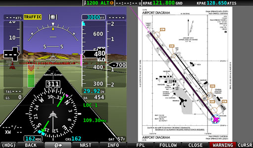

Through a unique Dynon-subsidized program with Seattle Avionics, Dynon is able to offer all available FAA, airport diagrams, and thousands of Flight Guide airport diagrams at an unprecedented price. There are no hidden costs and no separate VFR and IFR packages. With geo-referenced charts and airport diagrams, Dynon is able to offer experimental and LSA pilots a “paperless” cockpit!

For VFR pilots, I believe the new package will give you geo-referenced taxi diagrams. I don't think that is in the basic Dynon map package.

Dynon worked hard to give you a robust and affordable solution for charts. We partnered with Seattle Avionics (425.806.0249) and got the lowest price in the industry at only $99 a year in the USA for all your Georeferenced charts. That's airport diagrams, including over 5,000 FlightGuide diagrams, and all your approach plates, procedures, etc. Zooming, panning, and even following your plane on the center of the screen are all included.

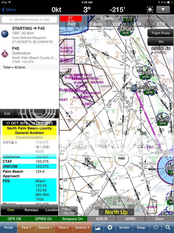

Like maybe WingX Pro7?
Very powerful and easy to use.
Anybody care to comment on your experience using WingX Pro?

I tried all the iPad flight programs. I ended up buying WingX even with it being more expensive. They all have their pros and cons. I really like the FLYQ program but it seemed designed to have your iPad horizontal. WingX presentation is great mounted vertical. (My iPad is mounted vertical). WingX is the big picture screen mounted on my panel. My skyview is the inside 20 mile traffic/close picture screen.
Information on wingX is so easy to access I haven't pulled freq or airport info off the skyview ever.

Not in a 12, but a Skyview none the less. I've been waiting for charts to be added for a while. I love them and have had no issues. The only issue is user error - I'll sometimes forget to plug in the USB drive. The drive must be plugged in to use the charts. The final feature is sectionals and ELAs which were just announced for the next update! I have an iPad and iPhone with WingX for backup, but like you stated, my iPad never comes out of my bag. I use it exclusively for planning.
I just downloaded the FlyQ EFB to compare with WingX. I guess it is what you're used to, but while it has some nice features, it has some annoyances as well. Maybe I just haven't played around with it enough, but at this point I don't think the special Black Friday price isn't enough to make me stray from WingX.
I bought the package. I pondered for a while (something that happens every time I have to open my wallet.) But, being a paper chart guy, and liking the airport guides, I figured buying a set would set me back way more than the $99, so I sprung for it. I figured it would be pretty much a one-time buy.
I just use the airport Diagrams. They work very well, and pretty much as advertised. Previously, my wife kept the book open on her lap for my quick reference. I think the little airplane following you around on a complex airport is a major improvement in ground safety.
After looking at all the IFR charts, I may try a few practice R-NAV approaches and see how those work out.
There are a few kinks that I think need to be worked out - or I need to become more skilled in the use - but I will post those over on the Dynon Forum.
All in all, I'm pleased with the purchase.
