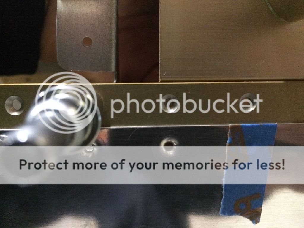

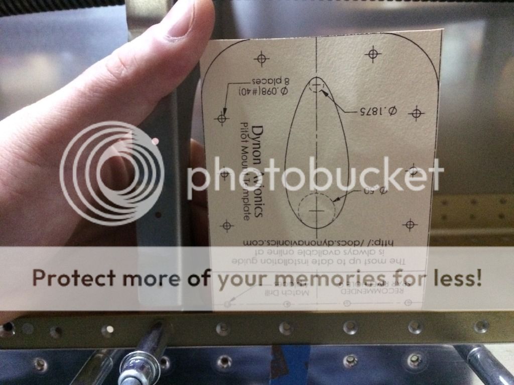

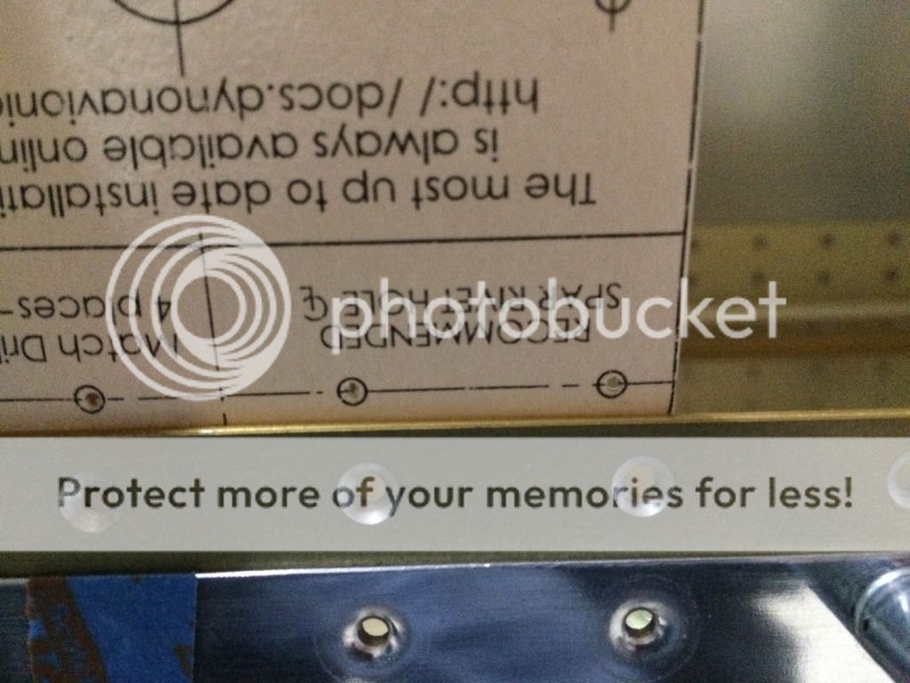

Good morning, I am building a RV-10 and in the process of planning for the mounting of the AOA/Pitot bracket the same place Van's calls out theirs. I noticed that when I line up said bracket that the holes in the wing spar that the outer holes are very close to the edge ( just under 1/16" ). Is there a different mount for the RV-10? Am i missing something? The template provided is exactly the same as the pitot mount, so no discrepancy there but the holes on the wing spar are slightly further apart from each other than what is shown on the template which would then mean the holes for the wing skin will be off too.
I did some looking around on-line and there are only a few pics from the inside showing how close the outer two rivets are on that bracket. just thought I would through this out there... This group is a great resource to bounce this stuff off of.
Thanks in advance.
Robert
Thanks in advance.
Robert
