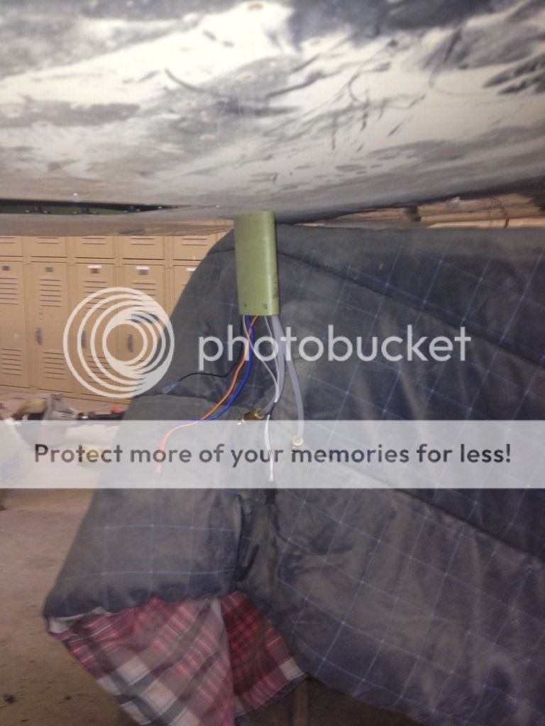

I placed an additional 1/4 plastic grommet next to the hole already in the ribs and ran the pitot and AOA lines near each other. I also placed plastic conduit, zip tied, through the lightening holes in the event the stock hole Van's placed in the rib was insufficient. Good I did as I needed this to run the roll servo harness in that extra conduit.

Not sure if you can tell from this picture, but the pitot and AOA are run at the base of the ribs, I drilled the holes not to far apart.
Leave yourself enough "service loop" in your wiring and plastic lines inside the wing to be able to unscrew the pitot from the mast, drop it down and disconnect from the outside. You can secure the service loop easily with wire ties from the access plate beside the pitot mast, but it's a LOT easier to do the connect/disconnect routine with it hanging free from the wing rather than flat on your back under the wing fighting through the access plate.
