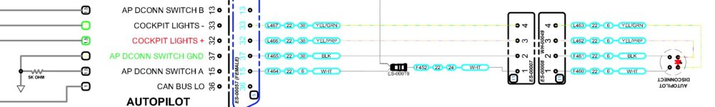

I attached a schematic (from Van's) of the autopilot disconnect switch. I edited out extraneous stuff. A 10k ohm resistor across the switch would be a ideal way to check for problems but I don't see it on the schematic. I'll crawl under the panel and double check but I don't expect to find one there. I'll let you know. I'll probably end up disabling the warning as was suggested.

Looks like they have a NO and a NC contact monitored within the same switch. Start by checking connection of all four wires. If other people are noticing similar issues, then it might be a firmware/software issue. Have you checked with Dynon support?
It is an option in the setup menu to enable the check. If there is no resistor in the system then just ensure it’s set to NO
SETUP MENU > AUTOPILOT SETUP > DISENGAGE BUTTON > ENABLE BROKEN LINE DETECT to “YES”.
There should be a 5k ohm resistor connected from the yellow (yellow on servo) disconnect line to earth for it to be set to yes.

Zoom out a little :) the resistor is in the AV-50000A. This kind of defeats the purpose, as a break in the wire between the AV-50000A and the switch wouldn't be detected.

If you connect the 5K to a NC switch then it should work, since the 5K in series would be sensed all the time except when a disconnect is requested.

Duh, missed it. Thanks! I suppose if splice ES-00019 is fairly close to the switch then it might do some good detecting a broken wire. But this leaves out an in-line connector and the actual switch. Not perfect but better than nothing I suppose. Seems hardly worth the effort.
