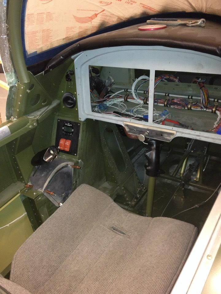

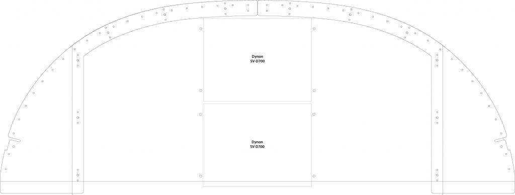

I have two 7" screens stacked in my -8. I didn't need to cut anything behind the panel to make them fit. Talk to the guys at Steinair. They have all the panel hardware CAD templates and can help you design whatever you need. I think I spent around $200 for their services--totally worth it (and I bought all my avionics from them too because of their service and prices).
The layout works really well for me. Before installation, I was a bit worried that the screens would be too small, but in the -8 you're sitting so close to the panel that they are plenty big. I'm very happy with this setup.

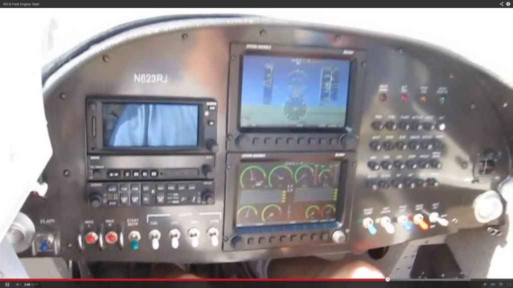

Paul Dye has a couple of GRT screens, I believe the 8" ones in his RV 8.
Photos should be in http://www.vansairforce.com/community/showthread.php?t=5018 also, lots of other RV 8 installations.
Sure I would love that setup, but I still need my radio stack to go somewhere.
Remote mount the radios, control them through the EFIS---------many of the newer big screen units have the option to do this.
In the photo above, there is an intercom and a radio above the EFIS units-----just not the standard looking ones. And looks like a SL30 below.
