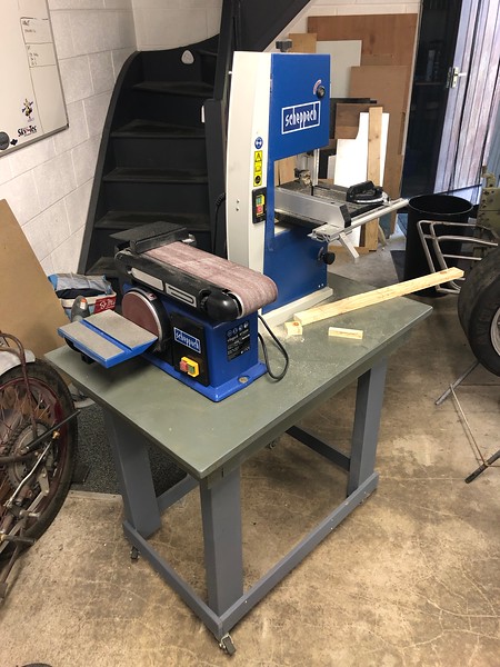

Planning to order a tool kit from Cleaveland or planetools to start my -10 build. I wanted to purchase a band saw and drill press too. Any opinions on if a lighter duty band saw and drill press is adequate for this project? Don?t want to go too cheap but also don?t want to spend more than is necessary. The WEN bench mount drill press and band saw, for example.

Make an all in one for the bandsaw - include a sanding table.
Stick it on a mobile trolley and wire both into a common plug. You take it to where the job is and then it can be hidden in the corner.
