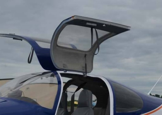

Iflyrv10 door strap installation
Does anyone have a picture of where they installed the pull down strap? How well does it work there? Would you pick a different spot if you did it again?
I have a short wife who could use a little help closing the door.
I like mine....
Not the greatest pics, but it should give you an idea. My straps came with my FlghtLine Interiors RV-10 package. The strap attaches with 2 screws that mount into rivnuts. No reinforcement of the underlying door structure is necessary. There's a button/snap screw at the top of the "loop" that allows you to snap the strap horizontally aft under the window to the door for storage, but I rarely bother.
While not strictly necessary, I do think they make closing the doors easier, especially for passengers.
I had the same strap setup as Todd. After the first few flights I realized they are not needed. Just reach up and grab the forward edge of the door near the top and bring it down. I found it to be a PITA unsnapping and re-snapping the strap.
.....I have my straps a bit aft on the door for two reasons. It allows me to pull the back part of the door in while closing, and it provides an easy way to close the door from outside the airplane without getting back up on the wing.
+1
Other words for minimium required.....
Yep, it's easy to reach forward and pull on the door when sitting in the seat. I find them invaluable for closing the door when I am OUT of the airplane. :)

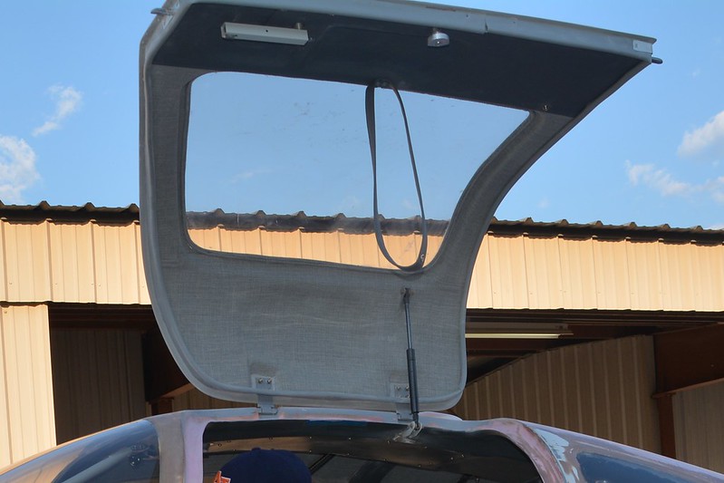

Follow up
So, 6 years after posting the question and 4 years after the first flight, I thought I?d give you my thoughts. I installed the door strap and love it! I?d do it again but I?d also agree with others that it isn?t necessary. My installed a doubler with nutplates for anchorage and then Oregon Aero made leather straps. The straps are short enough to never get in the way of door closure but long enough for me to reach them while inside the airplane or out. I think they are elegant and functional. Here?s a pic so you can decide for yourself.
Strap pictures
Thank you all for your pictures, ideas and comments.
My 5 foot 2 wife doesn?t know it yet but she will appreciate them as well.
I think I now have a plan on what I will do. Pix of my installation will follow in a few days.
