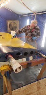

On previous planes I set up a homemade booth by putting up a temporary wall in my shop, furnace filters in window and an air lock with a couple of exhaust fans. The space has since been used so I bought one of the blow up booths. Easy to set up and works well. Did 12 wings and tail this fall with remainder planned for Spring. Only issue is that the bright Sun made it like a hot house so paint setup quicker that expected. Solution was to paint later in day when in shadow.

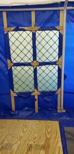

I painted my Hatz classic on the driveway in a Harbor Freight carport based booth. Two fans provided positive pressure with furnace filters at the inlets and exits. LED strip lights provided illumination. I was able to fold up the sides when I was not actively painting and to avoid damage from storms. Worked great

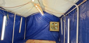

Here is the paint booth I made from the remants of an old party tent. The filters and exhaust fan did a nice job, as did the water separator on the air line.

The DIY framed paint booth with extractor fan, filters and lighting is about $500. I spent another $1000 on a bigger compressor that can run the spray gun continuously and a positive feed respirator to avoid breathing the ISO's.

I built a spray booth in my barn out of a $100 "party tent" I found on Amazon. Added some filters and a Harbor freight exhaust fan.

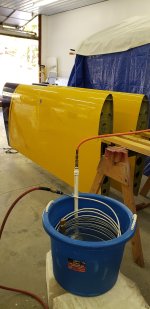

You are so right. The equipment is a major need. I have an 80 gallon compressor that feeds to a Craiglist $120 gallon volume tank. I now have 200 gallon of air storage and what comes out is DRY air.
I used to be in the stock car circuit 50 years ago and had many problems with water/junk in the paint from not enough volume etc. Maybe to much beer also.
I also have an active dryer after the 200 gallon storage system for painting.
I have Very dry air.
I am covered in the premium gun area. And the booth also.
