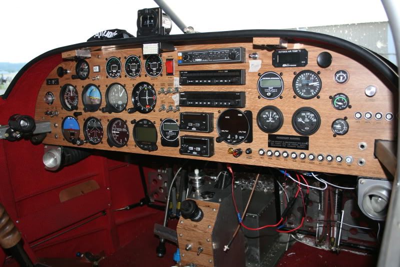

I fly our RV-6A in Cross country air races that have some extremely tight turns as well as some mild ones. Before a race I do a lot of preparation work and have a race checklist with a page for each leg. One of the key items is the heading outbound after the turn at the end of the current leg. The objective is to stand it on it's ear and get moving in the new direction as precisely and as quickly as possible (high speed in the wrong direction is worse than inefficient). Anyway I had a RC Allen DG that was drifting badly so after living with it for a while I bought a new Sigma-Tek DG and the function was so good it was near perfect. OK get the picture?
I raced in the Rocket 100 at Taylor Texas last month with my nearly new DG. Turns 5 and 6 were less than a mile apart and each one was on the order of 90 degrees. Because of the wind I planned very high rate of descent between these two turns in order to come out under the headwind on the way to turn 7. I was really relying on the DG for the rollout because the Pictorial Pilot heading display goes blank even on standard rate turns and these are way beyond standard rate (very high bank and using elevator to bring it around). Here is the point of all this lead-in: As I am making turn 6 the DG looses its stability (tumbles?) and I just have to guess at the rollout point (which turned out to be an undershoot) and the DG was indicating some random heading after I was cruising level to turn 7. I reset it of course but I had this feeling that it was not performing as well as it had before. Last week I had to put the plane in for the 2 year static system and encoder check for IFR operations. After it came back I made a test flight of 0.7 hours and it seemed to me that the DG was drifting similar to the old RC Allen unit.
Is this a normal failure mode for this kind of operation? What is the actual internal failure? What can be done to prevent recurrence while retaining a vacuum driven DG?

Continual g loading is hard on any gyro. Perhaps consider a digital like the RC allen, or keep the vac system for your IFR cert, but add a quick panel like an Extra 300 to quickly remove the AI and DG. In their place(also on a matching quick panel you might carry in a gym bag for racing) consider an MGL exteme EFIS with a lightning fast 50 channel GPS or a Dynon with a digital heading and solid state inertial sensors., or perhaps an Aspen EFIS like they put in the Extra 300 touring model. Try your thread in the glass panel section for fresh ideas there.

I just spent a large amount of time, effort and money modifying my panel to accommodate an SL-30 and indicator while retaining my old Terra VOR/LOC/GS. It pains me to go through that again but your reference is impressive for price, size and function because of your personal recommendation. I will study it.

Bob, just replace either your TC, attitude indicator, or VSI with the Dynon, it is sized and drilled to fit a standard 3 1/8" instrument hole. It most likely will slide right in without having to mod your panel. Hookup is simple--tee into your pitot and static lines, and connect a simple connector. The biggest time investment will be installing an external magnetometer in the tail of your plane and running the cable to it. The device has a magnetometer built into it but you will probably need the external magnetometer to get best performance. Lots and lots of info on this install in the forum archives and on Dynon's forum. I suggest you also purchase the optional wiring harness because it will save you time and effort making the the installation almost plug-n-play. :)
I'm a pretty good wire and plumbing guy
I'm a pretty good wire and plumbing guy - that kind of thing is easy for me. The flange footprint may cause some problems but my first thought would be to install it as a direct replacement for the DG. Mounting the box in the tail is a piece of cake as is running the wires. The part that requires thought and planning is the installation in the panel including all of the stuff I have in back of it.

The Story from Sigma-Tek
I talked to Jim Hearn, Engineer at Sigma-Tek and we talked very candidly about my situation and application. I took notes but I could have missed or misunderstood some things - anyway here is my progress report:
- Somewhere between 55 and 60 degrees in the 4000B directional gyro, one of the gimbals comes up against a hard stop where a condition called Gimbal lock occurs and the Gyro will tumble. This is not immediately fatal but it will eventually cause mechanical gyros to fail as indicated by increasing drift rates due to mass shift balance and/or increased friction in the gimbal bearings. The gyro speed is 22,000 rpm. The operational drift tolerance is 4 degrees in 10 minutes. In production the objective is zero drift but the reality of cost and income sets the acceptance limit at 2 degrees in 10 minutes. The technology exists for 360 degree freedom of roll as in jets but the cost is prohibitive for general aviation.
Test method suggested by Jim is this:
- Start up the plane and allow the gyro to come up to equilibrium speed (say 10 minutes) then taxi out to the runway, line up and set the gyro to an exact index mark on the compass card. Takeoff and fly twice around the pattern with nothing more than standard rate turns, then land, line up exactly the same way as in the before take off check and recheck the indicated heading. If the drift is more than 4 degrees, the DG is degraded and needs to be serviced.
I am to call him afterward with the results and I will report back here.
Bob Axsom
I did the flight test
The drift after two large standard rate turn patterns the drift was 3 degrees. That is within the operational tolerance Jim Hearn specified.
