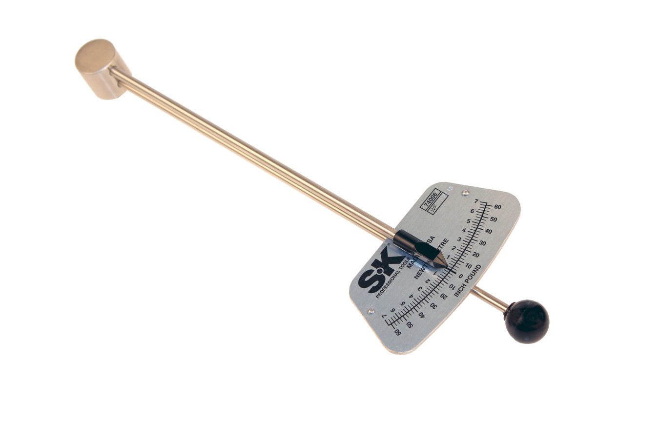

Something like this does a great job measuring those.
SK Hand Tool 74006 1/4-Inch Drive at Amazon.
