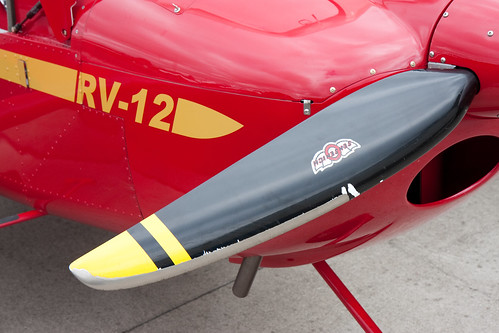

The wood-composite ground adjustable prop. This is what we'll get.

Ground Adjustable Prop?
Have they changed their mind on the prop? Nice writeup. Thanks. Awaiting Part II.
Thanks for the memories ...
Bill ... thanks so much for the report, pictures & videos. I hope we do get a ground adjustable prop.

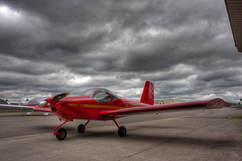

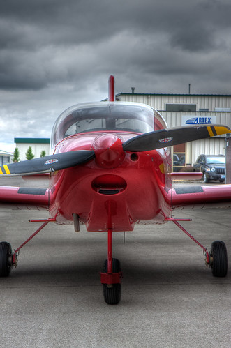

The menacing RV-12...
Back at the factory, I grabbed my big camera and took some pictures. I had been asked for some close ups of the canopy, so I tried to do that. I never built a plane, so wasn't exactly sure what to look for. I got a few HDR pictures of the exterior, and was done.

Joe said that is the prop people will get. They were concerned about high elevation users, so you can put it in a more climb configuration. From what I understand, if you have the prop in cruise mode and add the wheel fairing option, it will cruise right the 120 knot LSA maximum. Without the wheel fairings it will cruise around 116-117.

Not true (though that may have been the understanding who ever you talked to had)
It is ground adjustable with a specific limit to the adjustment range that will allow for max. cruse speed or a slight reduction in pitch if someone wants improved climb performance (with a slight sacrifice in cruise) if they are based out of a higher elevation airport, etc.
