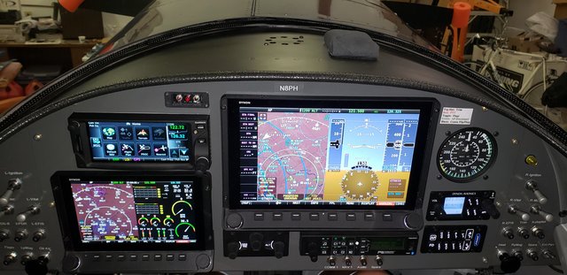

Photo is what I did for a single, smaller fan on the RV-8. On the RV-10 I used two 3.25” fans, one on each side.
Get creative on your hole pattern. The best one had a combination of 1/4” and 3/8” holes in an alternating pattern.

Carl,
What is the covered item to the right of your fan?
GPS antenna?
Covered for aesthetics? To keep it cool?

Not that Carl, but I'm pretty sure it's covered in dark cloth to minimize its reflection in the windscreen.

This is the SkyView GPS antenna/receiver. The cover is to eliminate the reflection on the windscreen.
This is where I mounted this antenna on all the builds - it has been flawless.
Side note - mounting a Garmin GPS antenna in this location goes against their install instructions and can create problems.
