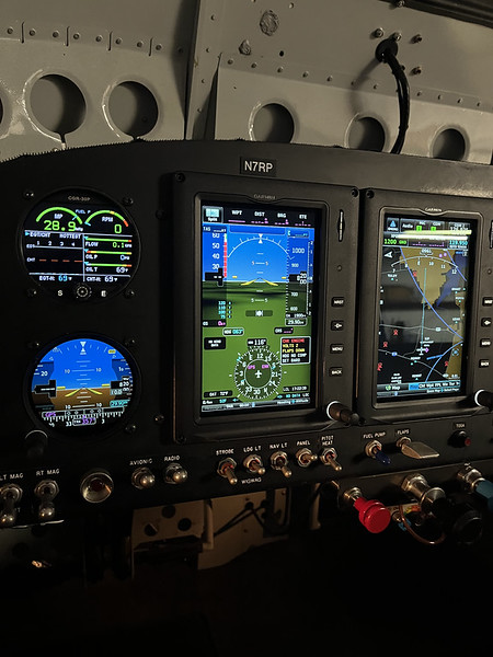

I recently upgraded our panel from a old school, VFR, round gage panel to a very cost effective partial glass VFR panel. As part of this project, I purchased a used EMS D-10 from Walt at EXP. I have been thoroughly impressed with this little unit. It operates perfectly, is easily readable in bright sunlight and has amazing capabilities. If you can find one, they are also reasonably priced and are still supported by Duynon.

EI CGR30P
Another huge fan of the Dynon EMS D-10 here. There is nothing obsolete or old school about it: Rich, easy to read display.
Find a used one and live happily ever after.
Walt - beautiful! So is the price tag!!

I am with Walt. The EI CGR 30P is an awesome unit. Works great and a beauty to behold. I too didn't like the price when I ordered it but after flying it for the first time I was super glad I went with it. I wouldn't hesitate to do it again.
