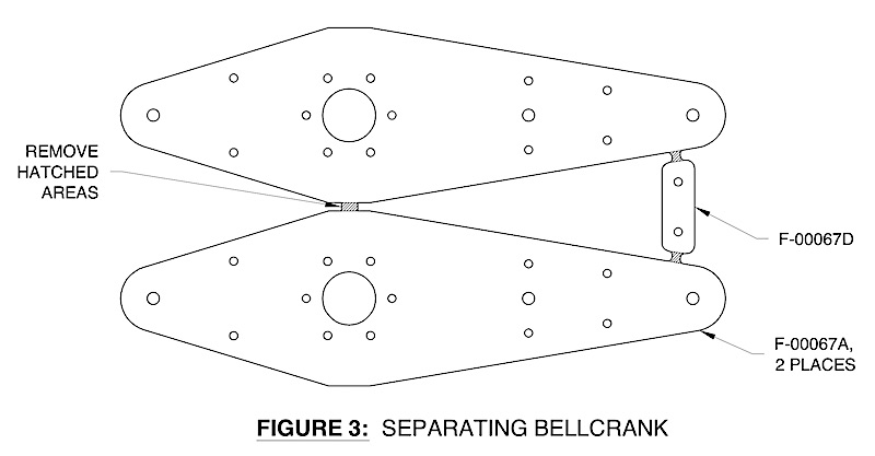

It depends on which model and what parts you're going to build. The older kits require quite a bit of cutting and fitting and drilling before they're anywhere close to being ready to deburr or prime. I think that even the newer kits require some of that.
An example is the elevator bellcrank, which needs to be cut apart. This example is from the RV-14 plans. It needs to be separated into three parts and then riveted together with a bearing installed.
The time to do the deburring and priming is when the parts are separated.
