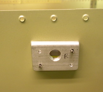

My QB wings have about 1/8" gap between the skin and the bottom edge of the long threaded block that the tie tie down ring screw into. If I don't deal with it, the skin will deform (probably not permanently) when I tighten a lock nut. I would like to get something in there to bridge the gap.
I am thinking JB weld or epoxy and have some ideas on doing it without it getting into the threads. However, I am curious if someone in the group has come up with a good idea for dealing with this.
Larry
