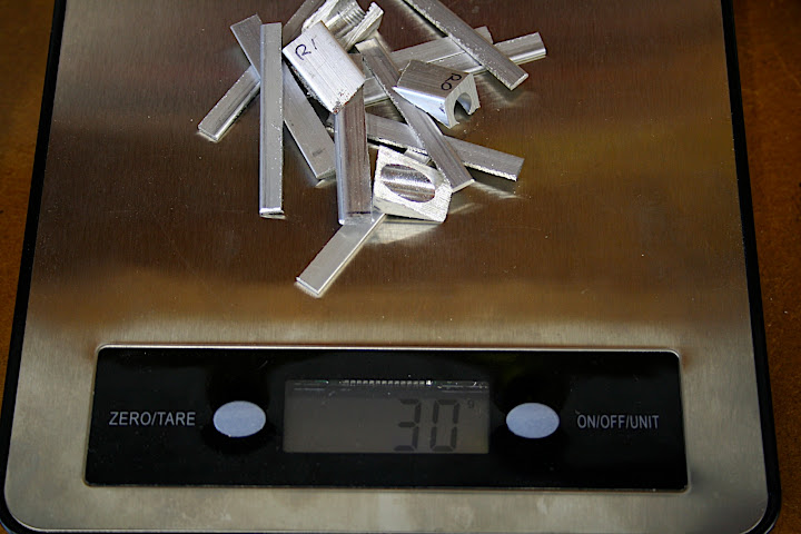

I may be burned at the stake as a heretic, but the weight savings vs the effort is not worth it for this part. I did not like my first efforts at making these, so I bought more stock and kept at it. I finally got ones I liked using my chop saw to cut the angle. All told I probably saved about 10 french fries worth of weight. Yes, if you keep adding all the bits of weight saved for the whole plane together it is a pound or two. There just isn't much variation allowed in a 12 to amount to a real weight savings. It is more of an attitude than a real difference in this plane.
If you are having a problem, just drill and tap, and forget the 30 deg angle. Yeah, it looks keen, and it shows the right attitude, but it will make zero difference in your final weight.

Weight saving 30gr=1oz
Scrap pile
My scrap pile is a whole lot bigger than that! But the majority of it is from ruined parts that I had to re-order. LOL
