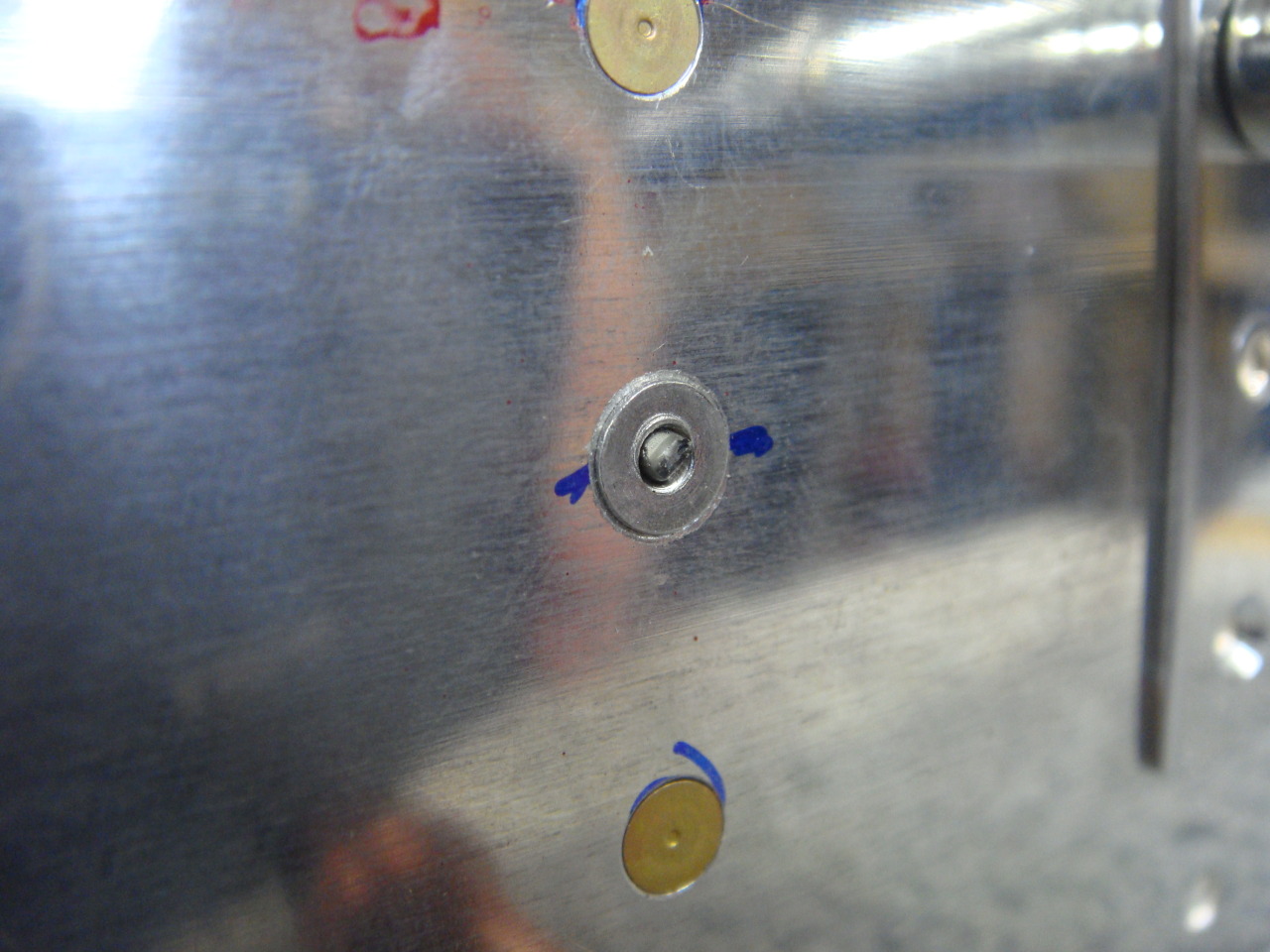

I installed my first CS4-4 flush rivet with a hydro-pneumatic puller today and the rivet didn't snap at the end of the pullers cycle. So I cycled the puller to finish the rivet. The rivet snapped above the flush head.
Do I need to drill this out and go again? Or can I just remove the excess center? I installed 4 of these and 2 of them failed like this one.

I'd knock out the mandrel and drill it out. The more important issue is whether you need a new puller that will pull the rivets as designed. Did you try using a hand puller on the CS rivets?

Are you sure you are using the correct rivet?
Is it possible that CS4-3's are called for in this location?
When the stem pulls above the rivet head it is an indicator that the rivet is too long of a grip length for what is being riveted.
I also can tell that the tip on your tool has too large of a hole in it (the raised ridge being left in the rivet head around the stem. The hole should match the stem diam as close as possible. It is not likely that this is causing your installation problem, however.

I triple checked the plans (Page 09-03) and it only calls for CS4-4's. I think 4 of the CS4's called out in the plans could have been -3's instead of -4's due to thickness of the material. The puller I am using is from Cleveland Tools made by NUMATX.
Pic:
I struggle to think this puller wasn't designed to handle these rivets. All the other rivets were pulled flawlessly.

I also confirmed that it does call out CS4-4 's at this location so I suggest the following...
Change the nose piece on your puller to one with a hole that closely matches the stem on the rivet.
Turn down the line air pressure to about 60 PSI and try and pull a rivet.
If it won?t pull the rivet, turn it up in 5 PSI increments until it does.
It may be that your fancy puller is able to pull very hard, very rapidly with high pressure, allowing the stem to pull in further as it is breaking off.

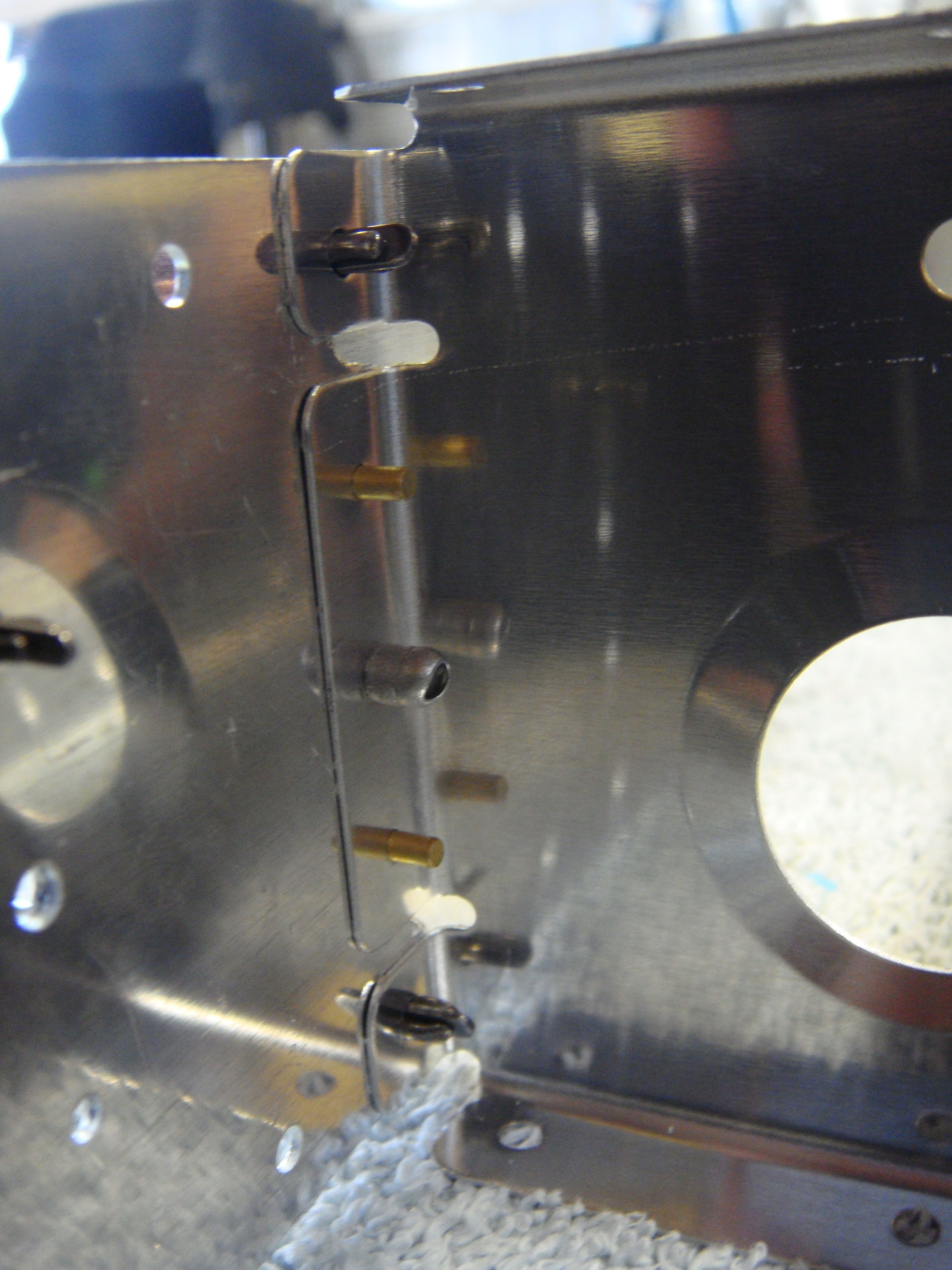

Gary - This is a pic of what the puller looks like when I took off the chrome housing. I adjusted the mechanism as far aft as possible. This allowed the puller to correctly separate the mandrel on a few test rivets. If I adjust it forward like I found it, the rivets won't separate. The stop nut was loose too.

In your top photo, the two black pieces to the right, are the exact ones I was mentioning. I'd bet that by mating these two pieces, you'll find the rivets much easier to pull, and breaking where they are supposed to! I see a small gap between them, and that's not supposed to be there. I believe the tip size is fine. I think you'll find it was those two black pieces being apart....the breaking of the mandrel obviously occurs within those two pieces. If it's out of adjustment, nothing will pull the way it is designed to.

Thanks for forwarding me the link to this thread. I have been absent from VAF for far too long as we have been consumed with tool development. The question here is one that many users of the power pop rivet tools don't understand, so I thought I should make the reply public.
As others have said you want to use the smallest nosepiece that the mandrel will fit through.
For the greatest stroke the hex nut shown in your photo above should be placed in the furthest aft position, then the two black barrels should be tightened up against them with no gaps. Normal rivets should then be able to be pulled in one stroke.
When pulling shorter rivets, you may want to run all three pieces forward a bit (still tightened together) to limit the amount of recoil experienced. If you are like me, I push a bit on the material to make sure the rivet is seated properly in the material. With too much stroke, the puller will recoil when the mandrel breaks and leave the material. The manual pressure being held causes the user to hit the skin with the puller head. When adjusted correctly, the puller should just click when the mandrel breaks, with no noticeable recoil. As a measure of security, I generally hold the puller nose in a saddle with my left hand, placing my thumb and index finger on opposite sides of the nose piece and against the skin. This allows me to control the nose as the degree of freedom is added when the mandrel breaks.
Now to address your actual question... I would think that it is either too long of a rivet for the material, or more likely the two barrel parts are not jammed tightly together as shown in the photo.
Quick Follow Up
Tim sent me a photo of the smallest nose-piece for his puller. There was a countersink where the maker had 'overdeburred' the hole. (Sounds like other common forum topics). This will have the same effect of sucking the rivets up into the nose-piece as using the wrong sized nose-piece. I have faced off flat, one of the nose pieces that we had here for Tim. Others may wish to do the same to control the look of the finished rivets. Feel free to send me your nose-pieces if you wish and I will do the same and return it to you. Really I am just trying to set the internet record for the number of times "nose-piece" is used in a paragraph.
