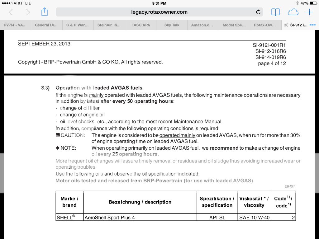

The word on the street at OSH last summer was if ran pure unleaded fuel you could change oil every 100 hours. However never saw that in print anywhere. So as far as I know it's still the same in all the current Rotax documentation. If you run 100LL more than 30% of the time you need to change oil every 25hrs. Less than 30% of the time then 50hrs. See this document below. Google it if you want by using the SI number in the upper right hand corner of the pic. Maybe Rotax Guru Roger Lee could comment if I'm off base.:rolleyes:
Maybe it's too early in the morning but this document makes it perfectly unclear for me as to what should be done. :confused:

100hr oil change
Take a look at the Line Maintenance Manual Sec 05-20-00 Pg 3 at the bottom. This seems to indicate a 100 hr oil change if not using leaded fuel.

I believe the parameter which determines the more stringent specs for maintenance is 10% or more use of leaded fuel. IMHO, Rotax wants us using MOGAS. Fortunately, many towns now have 1 or more stations with alcohol-free hi-test. I assembled a cheap but very effective 15 gallon fuel caddy, and my bird gets nothing but pure gasoline 95% of the time; no lead, no alcohol. The absence of lead additive keeps me on the easier maintenance schedule, and the absence of alcohol additive means infinitely longer life for rubber parts, seals. I also keep the tank nearly full, as my fuel has NO water in it, whereas air does.
