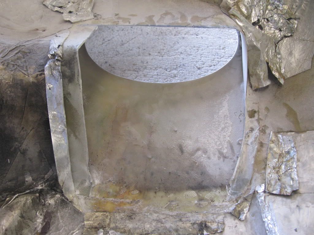

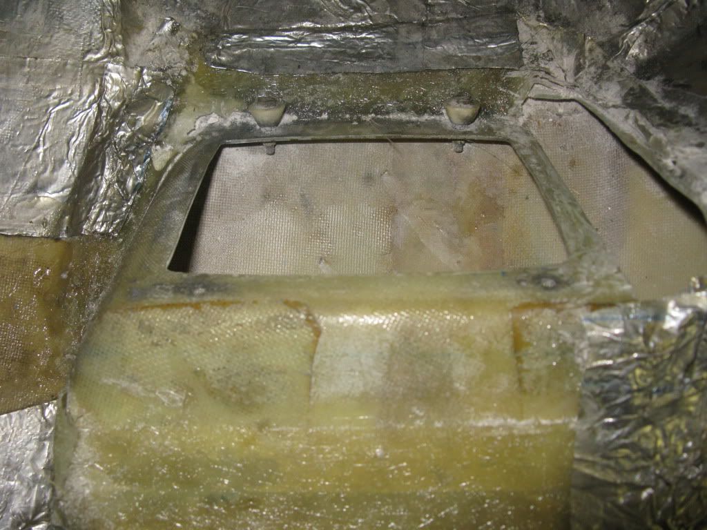

Considering the numerous plans that I have sent out I thought I would start a separate thread on this subject. Pete just finished his mod. and was good enough to send me pictures. Too bad I don't know how to get them on this thread. Maybe Pete can get them on. Anyway, he reports that the mod has helped. If you have any questions about how this started, look up "Boiling Mad" from several weeks ago. http://www.vansairforce.com/communi... I will forward Pete's findings and pictures.
Dave,
I modified mine last summer, as did a friend, in a manner similar to what you describe in the mentioned thread. I think I brought the cooler forward 1.25", which as I recall was about as far as it could go due to other clearance issues. It did help both of our plane's oil temps. I believe mine improved by 10 deg f, and I don't have any worries now. We also added an aluminum heat shield to the muffler. I can't seem to find the photos I had - Would like to see yours.

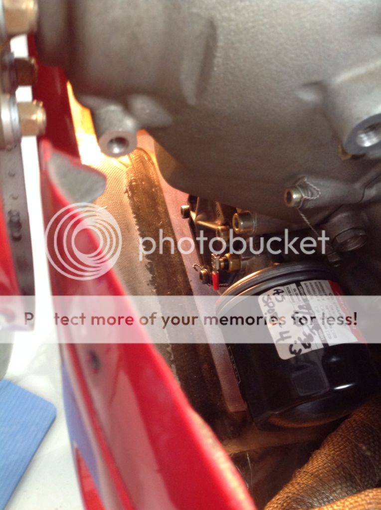

Oil Cooler Installed Pics

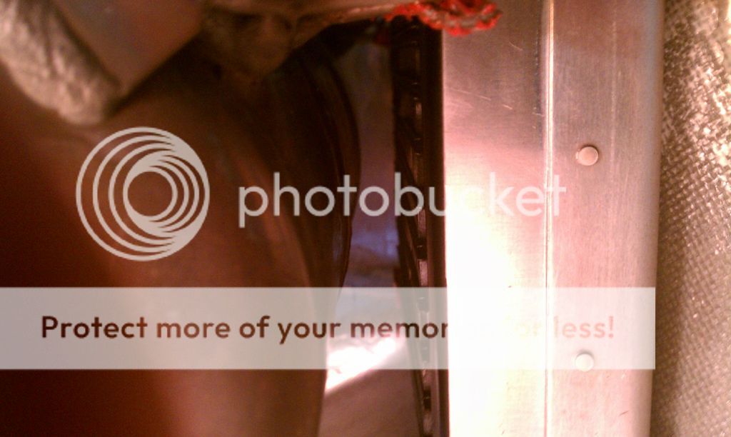

I think Dave is on to something here. See the following Pictures of My oil cooler clearance with the lower cowl installed. As you can see it pretty close. I wasn't able to get a ruler in the picture but your looking at about an 1 1/4 inches between the two. I just thought about it and anybody who has access to their oil cooler could measure the aluminum braket at the right side of the picture to use as a measurement reference and then post it here.

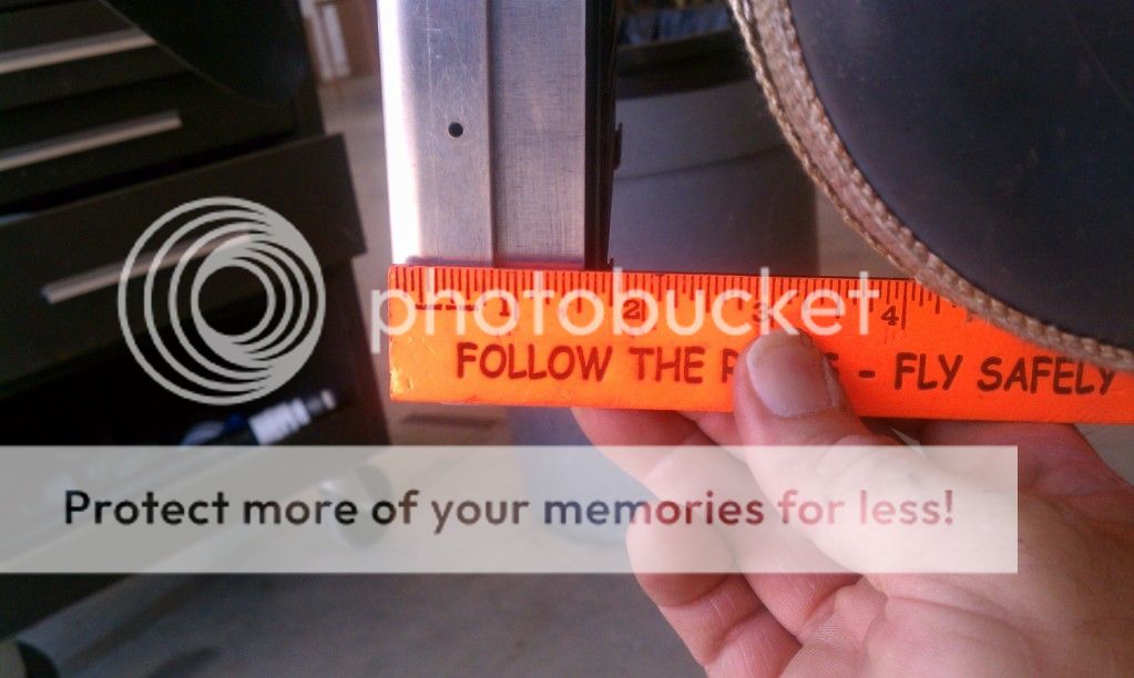

Follow up of Oil cooler Pictures.
As a follow up to my previous post. Right now I'm not going to modify my cowl like Dave's because my plane is done and painted. Ive developed my own strategies to deal with this problem. I only have high oil temps from June through August. As with Pete and Larry and the Rotax manual I keep the oil temp below 250f over most of the operating period. If operating in OAT temps of 90F to 100F I may have to make a reduced power climb no matter what the speed I fly to keep the temps down, I may run Mobil 1 synthetic for the summer months which is recommended by Rotax if I intend to operate above 250F for most of the flights.
Having said that, If I were to build another RV12 I would absolutely do the modification. Furthermore I think Vans should change to cooling duct to give more clearance between the muffler and the oil cooling radiator. At the least they should put a note in the directions letting builders know that this clearance is important during assembly.;)

I moved my oil cooler forward and have not seen oil temps in the yellow since. The OAT's have been around 90 each flight. This mod definitely worked for me and thought I'd pass on my results.

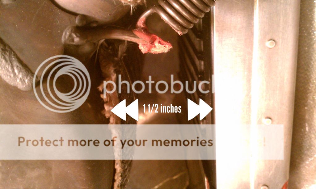

Jetguy, I don't have pics but my measurements indicate that the bottom of the oil cooler was moved out about one and a half inch and the top about three fourths of an inch. The top moves out less because of the oil line length restriction. The bottom of the cowling slopes up so the oil cooler moved up higher one half of an inch as it came forward. I tack glued it in place and did a trial fit to check for clearances before glassing it in. There are two safety wire tabs on the bottom of the engine that I had to make relief for in the fiberglass just in front of the oil cooler. A trial fit will show any clearance issues and it took me two tries.

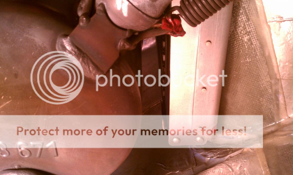

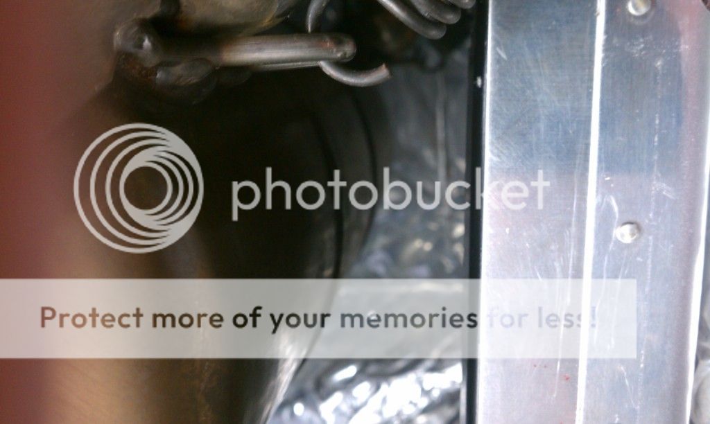

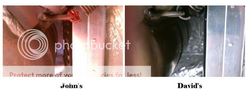

Oil cooler distance update
Here is a side by side comparison of my oil cooler picture to Dvalcik oil cooler picture. Note the upper spring location.
Mine,
Daves,
Side by side,
John, it's forecast to be 90+ tomorrow. It will be interesting to see what Dave's oil temps are. Dave's clearance is about what you get after the mod..

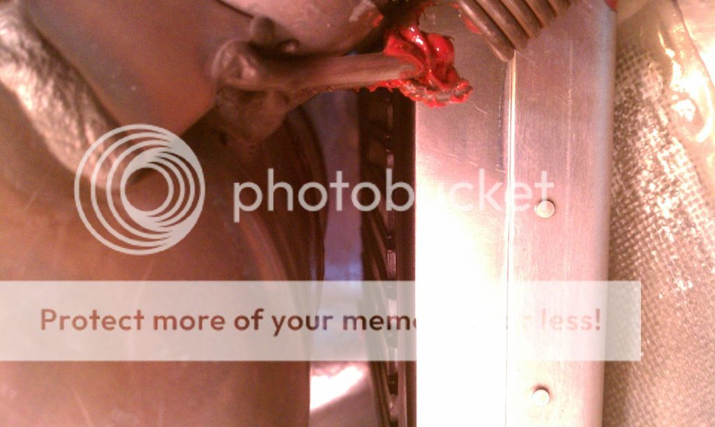

Distance between Oil cooler and Muffler!
Thought I would update my last post with one last picture to
use as a reference to gauge the distance between my muffler
and my oil cooler! So I would say that the distance that you see
in my earlier posted picture picture of my plane is about 3/4 inch.
Davids distance is closer to 2 inches. David does not have any oil
cooling problems what so ever. So using the above statements
other builders need at least 1 3/4 inches spacing as a minimum
to get the cooling expected from your set up. It would be nice if
Scott would go out and measure the distance on Vans red RV12
with the lower cowl installed then we would know with out a
doubt. But with out that this is my best estimate.

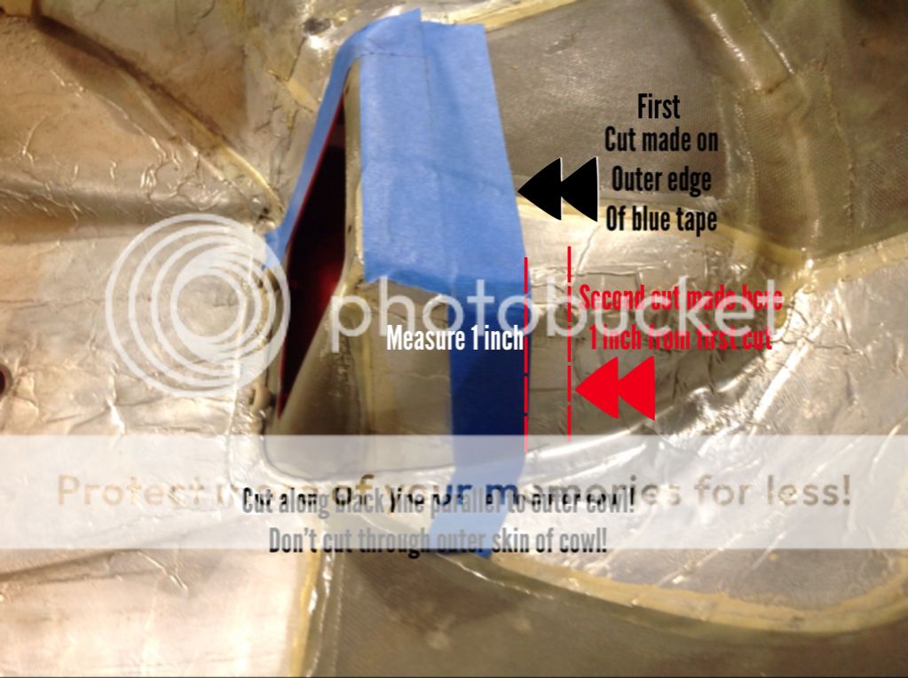

Since the weather has been really cold I thought I would take some time to revisit this problem and make some corrections before summer hits. I won't have time then. As you can see from all my previous posts I had about 3/4 inch between my oil cooler and the muffler. Starting in June and ending in mid September when the first cold front comes though and breaks the summer heat I run some high oil temps. I can usually work around this problem. It becomes a bigger problem when trying to climb high to find cool air on the way home from OSH during the middle of summer. During the climb with OAT in the high 90s I would easily see oil temps above 250F even if I step climbed to altitude. When I flew Dave Valciks plane he had approx 1 3/4 inches spacing. When we did the 75kt climb to 10,000 while doing his flight cards he didn't have any high oil temps so this convinced me to do the mod when I found time. So here it is with some new pics for guys who may want to do it later on.;)

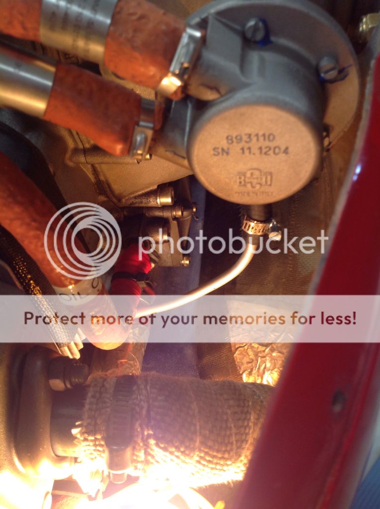

Hose lengths with this mod
John,
I'm curious/concerned when moving the radiator forward, as I recall, the hose connecting to it (on the back) is pretty tight and maybe not amenable to another inch of extension. Maybe I have things routed wrong, but there doesn't seem to be any slack for moving it forward, even by 3/4ths of an inch. ?????????

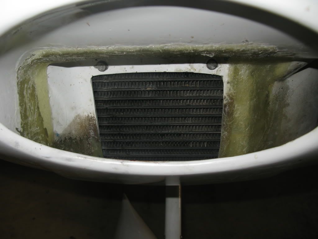

Oh I thought of that.;) Last fall during an oil change I rerouted the oil feed hose in anticipation of this mod. Then before starting the mod with the cowl off I manually repositioned the oil radiator to the my best guess.:D It should work fine. You would need 1 inch more to do the mod. This being my first airplane build and as I recall the directions were a little hard to read when routing the hoses. Fast forward to now with a much better understanding and a clear view of where everything goes I could even reroute the hoses one more time and get 2 inches if need be but I think I'm good for now.
John - great pics, I may do this. My cowl is painted. How did it look into the fishmouth when you were done before any touchup?
Also a pic of your revised hose routing please!
Bill, I did not have to touch my hoses at all.

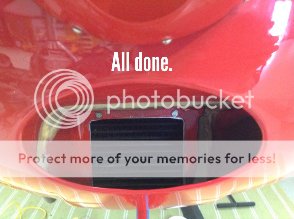

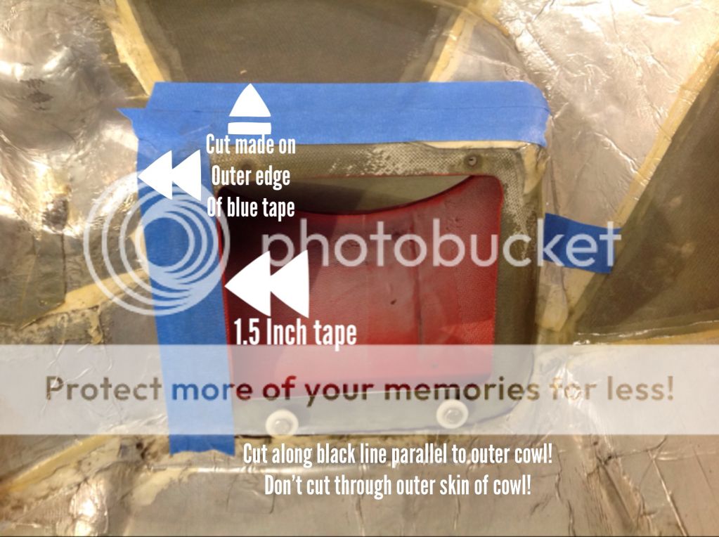

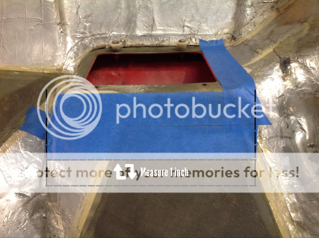

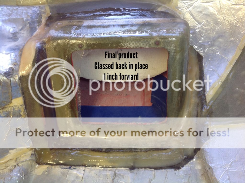

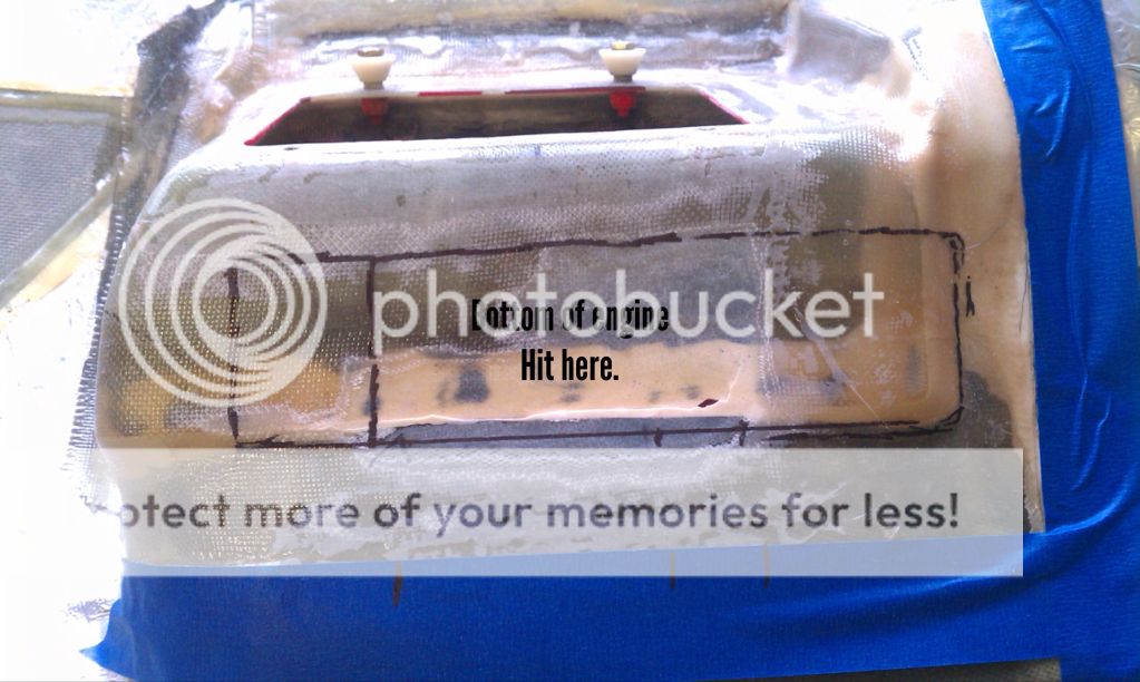

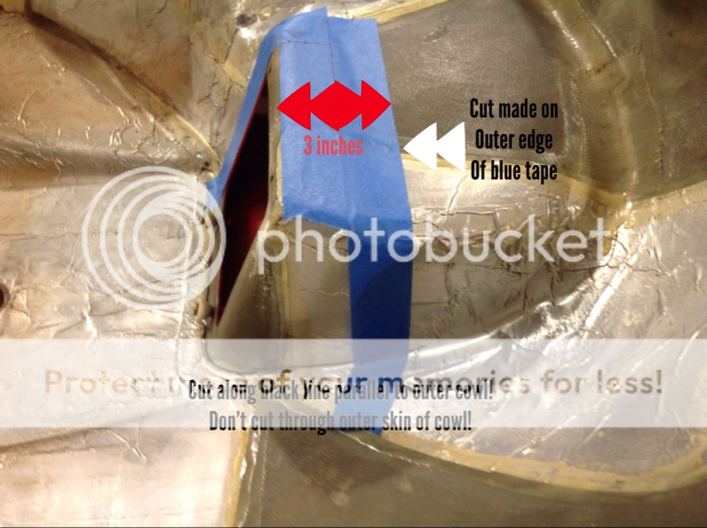

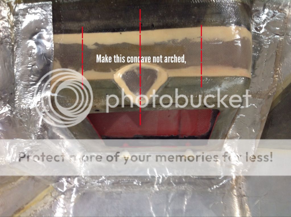

I'm all done with my cowl mod. Things a learned along the way. You don't want to arch the top part of the tunnel when you reattach the part where the oil cooler attaches as seen in the first pic. I has to go back and redo that area. I had to cut out that area and reglass it with a dip in it as seen in the second pic. There is a point where you can't go any farther forward with out hitting the bottom of the engine because of height of the square frame where the cooler attaches. In the third picture you can compare pics from my earlier post and see now I have about 1 1/2 inches between the cooler and muffler. Before I had about 3/4 inch, use the spring attach point as a reference to compare. The forth pic shows the final product. After I fly it for a while I'll go back and do the cosmetic work and then repaint the inside of the tunnel. I won't know for sure how well it works until the summer kicks end. I'll update when that happens.;)
Looking down the throat, seems to be...
a recent tonsillectomy.
Question: you are removing a 1-inch strip, and basically sliding the remainder forward an inch. By forward, I suspect this means "up a bit" also, hence the interference? Sliding it up, do the two edges basically match up on the same level, or is there a step in the glass at that point to join things back together--looks like it is perdy smooth, at least on the top, but a step discontinuity on both of the sides.
NIce thing about this mod is that its just fiberglass--don't have to deal with the pro-seal/devil's snot on this one--will reserve my aggravation for the tank SB :D.
Our machine seems to start out with less clearance--< 1/2", and I don't think we hit any red lines during last summer, but will still be doing the mod.
Yes that is what I did, cut out a 1inch strip and move it forward 1inch. No, the oil coolers frame won't line up perfectly. Just get it close then glass it in place. You might want to wait through the summer and see how yours does. Here are some pics after my final install of the oil pump for reference. You need at least 1/4inch clearance between the the oil pump and the cowl.
