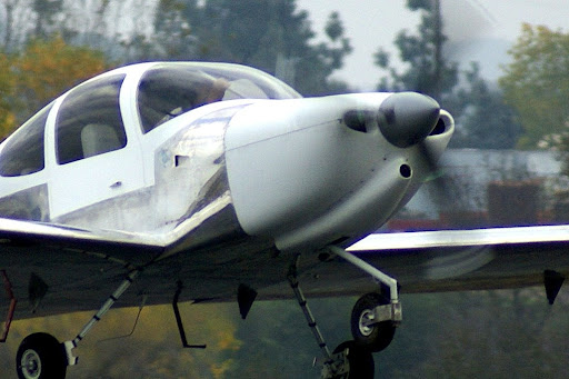

I have been fighting high CHT issues for as long as the plane had been flying.
The recent thread about sealing the piano hinge wire slot got me to thinking of what else might be causing air to enter the lower cowl and upset the low pressure area that should reside there.
Here is a shot of the lower cowl where there is a long slot for the nose gear to move forward when landing.
Due to the three blade prop, I extended the slot to make it easier to remove the lower cowl.
![DSC06035.jpg](/proxy.php?image=https%3A%2F%2Flh3.googleusercontent.com%2F-6FQTolz1e58%2FTijPkA7iKgI%2FAAAAAAAACfE%2Fg9L6XOdDoPI%2FDSC06035.jpg&hash=6e38c9ca4358517e2be89a287ab9e35b)
