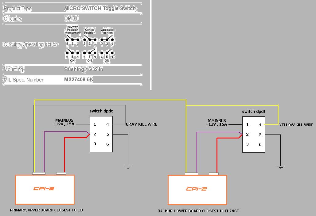

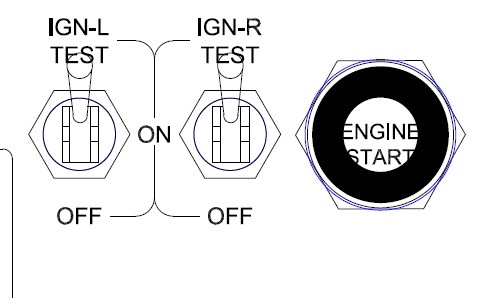

I'm finalizing a new panel design with SteinAir, and based on feedback from SDS, I will be using a pair of locking toggle switches to provide "off", "run", and "mag check" positions for each ECU.
That portion of the panel design looks like this:
This is a wiring diagram that I got from SDS. I understand that this was created by another SDS customer, and reviewed by SDS.
I'm very tight for panel space, so this makes the most of a limited amount of real estate.
It appears you have both CPUs and Coilpacks wired directly to the main bus through the switch. SDS recommends individual breakers or fuses for each CPU and each Coilpack.
You may want to double check this with Ross or Barry.

Re-read my post. I got this diagram from Barry. He has already vetted it. It originally came from another owner, but Barry sent it to me.
Interesting. I take it this setup only has two bus feeds (one for each switch) rather than the four described in the manual? What are your fuse/breaker values? Naively one might go with 20A by summing the recommendations from the manual, though it also seems like 15A might be fine.
It surprises me a bit to see this approved by Barry, because the manual is quite explicit about providing separate bus feeds for the ECO and coils, and using a DPST switch for them. The way it's written implies to me that it's important that those feeds be separate, but it seems like that's not the case - perhaps I'm reading too much into the documentation.
I too am surprised. Private guidance from SDS insisted on separate red and purple power supply all the way from the source bus or battery.
Breakers are to protect wires, not devices. If you power both the ECU and the coilpack from one breaker, all the wires to them need to be large enough that the breaker pops before any of the wires burn. So, if it's a 15A breaker, all the wires need to be able to carry 15A. That purple wire probably needs to be upsized. Other than that, I don't know why this schematic wouldn't work.

That switch is listed in the diagram as DPDT, but it is really a DP3T for those looking to use something like that. However, it only acts at a 3T when the jumpers are installed. It is needed in this case, as it continues to "make" the exsitiing connection (via a wiper) on one pole as the other pole "makes" a new connection in the top or bottom position.

Good point, Ed. I had not caught that. The purple is 20 gauge & the CPI doc calls for a 2 to 5A breaker or fuse. The red is 18 gauge & calls for a 10A breaker or fuse. Looks like you would need to upgrade both wires to 14 gauge with a 15A breaker.
The purple wire only powers the CPU section. 2-5amp breaker, 20 ga wire which is already part of the harness.
Right, but if the purple and red wires are tied together on the same circuit - as depicted in the aforementioned diagrams that demonstrate using a single switch to both remove power and/or activate the killswitch function - then that purple wire will be protected by a 15A breaker, rather than 2-5A.
This seems to be the concern being expressed here - it may be OK operationally to combine ECU and coil power feeds into a single circuit, but it raises issues with proper protection of the purple wire in the harness.
Of course, none of this applies if the system is set up as depicted in the installation manual, with two separate breakers for each ECU (one for the purple wire and one for red).
Put another way, David isn't calling out a deficiency with the harness as constructed, but a deficiency with the proposed single-switch setup.

From Barry:
"Best to keep purple and red on separate circuits & breakers and use a double pole switch. The CPi2 should work if purple and red are tied together on one circuit but if the breaker or switch was not in good condition this could introduce some voltage fluctuation into the purple wire input and since this powers the cpu circuits, extra noise here is not a good thing to have. This is why separate breakers and a double pole switch are best."

There has been a lot of back and forth about how some people have wired their SDS CPi-2 systems and what works vs. what are the actual requirements / recommendations / best practices.
I agree that the documentation could (and should) be clear, definitive guidelines should be given for the recommended setup. Then, if you decide to deviate from that you at least know that you're deviating! ;)
To me the only confusing part was regarding the switching. The power requirements / recommendations are very clearly spelled out - a separate 2-5A breaker or fuse is required for each CPU (purple wire) and a separate 10-15A breaker or fuse is required for each coilpack. See the excerpt from the manual below.
What is confusing is the switching recommendations. For example, for the purple 20 gauge cpu conductor the manual says very clearly "you must have a dedicated switch for this wire" however two paragraphs later it says
"Four +12V sources to the CPi2 ecu need to be switched. If you have an existing Mainbus switch you could wire all 4 of these to the switch but you will need to have 4 fuses or breakers between the Mainbus switch and each wire.
Dedicated switches are not necessary but some installers may desire this anyway. If installing dedicated switches then you want your breaker or fuse before your switch."
First off, on a dual CPi-2 system there aren't 4 - 12V sources to the CPi ecu, there are two to the cpus, and two to the coilpacks. Second, you can't say "you must have a dedicated switch for this wire" then go on to say "dedicated switches are not necessary".
Then it goes on to say
"Switching could be done using two DPST switches. One DPST switch for both Purple wires and a 2nd switch for Coil power sources +12V. Four breakers/fuses are needed here.
You could also do two SPST switches for each coil power source. Switch rating of 8 amps minimum.
Note, the red 18ga Coil power wire mentioned above needs a switch since there may be a small amount of current flow if it is not switched off, likely 3 to 10mA only but enough to run down your main battery after a month or two."
I realize that SDS is trying to give us a lot of options, but seriously, it would be nice to just have a clear "this is our recommended setup" diagram" and perhaps notes regarding why that setup is recommended.
Here's what I did that meets the strictest requirements / recommendations per the manual:
Unit 1
Power bus > 5a breaker > DPST Switch > Purple CPU-1 wire
Power bus > 15a breaker > DPST Switch > Red Coilpack-1 wire
Unit 2
Power bus > 5a breaker > DPST Switch > Purple CPU-2 wire
Power bus > 15a breaker > DPST Switch > Red Coilpack-2 wire
SDS backup battery, traditional key switch L-R-Off-On.
Unfortunately many people want to wire stuff their own way on the EFI as well as the ignition systems so we get many email and phone calls- I want to do it this way, will it work? Can I use this type of switch? etc. With people building their own planes, you have many different preferences. No two airplanes will be built or wired the same way.
We publish simple schematics for our recommendations on wiring the EM-5 but almost nobody follows that advice and we see similar things on the CPI-2.
The CPI-2 is more complicated in some ways because it has a backup power source in most cases and voltage sensing and switching circuits. It can be hard to shut down because it will just revert over to the backup battery and stay running. Any tiny amount of voltage leaking from other devices onto the power bus will keep the ECU active or partly so (often unpredictably) and we've seen a number of these issues from backup glass power sources.
There has been customer feedback and resultant changes in wiring the switches over the last year or so. Be sure to read the latest versions of the manuals. April 21/20 was the latest revision.
Here is what we recommend and we think that it's pretty straightforward (but maybe it doesn't suit everyone):
Are there other ways to do it? Certainly and some work just fine as we've heard on this thread.
Thanks Ross. I understand what you're saying, however I still contend the documentation does not convey that clearly at all. I recommend that you re-read this section and at a minimum make the "must haves" (i.e. required) and the recommendations not conflict with each other.
After reading, re-reading, and re-re-reading this area many times I feel that it could be highly condensed and simplified to read something like this:
"Each ECU requires two power conductors, one for the the cpu (purple) and one for the coilpack (red). We highly recommend a separate fuse or circuit breaker for each (3-5a for the cpu and 10-15a for the coilpack), and that they be able to be isolated from the main bus by a switch. The reasons for these recommendations are shown below, as is a recommended wiring diagram.
1. We recommend that a separate fuse or breaker be used because....
2. We recommend that a switch be installed to isolate cpu and coilpack from the main bus even though there is a master switch for the following reasons:
a) The cpu should be isolated because....
b) The coilpack should be isolated because...
3. We do NOT recommend using VPX breakers for the coilpacks because....
4. We also HIGHLY recommend that you install the backup battery because....
While there are many different ways to wire this system that very well may work, the above is our highly recommended configuration based on our experience and the design of the system."
These simple, non-conflicting instructions and explanations, combined with the wiring diagram that you posted in the link above would be FAR less confusing and would convey what you're trying to convey much clearer IMO.

So, you're running power unfused through a "main" switch and then putting a fuse after the controller? This confuses me. I would hope you're not running all your power through a switch. If you are running power from a "main" buss, isolated by a battery contactor, one would expect the fuses to be at that buss and not after a device or switch. If you have a separate dropdown panel for an "ignition buss", one would wonder how the wire to that bus is protected and why power is running through a switch and a device without protection.
I don't dispute that this will all work normally. My concern is what happens if any of the unprotected wires short. Depending on the location of the short, it could take down both ignitions as well as smoking and possibly starting a fire in the cabin. I guess the battery backup would probably keep the ignitions alive, but the smoke and fire are still a problem.
Ed Holyoke

People can cut power to the red and purple wires any way they wish. In the end, that's what's important. In our view, the easiest way is depicted in the published schematic.
Regarding the VPX, our caution is to set the breaker current for the coil high if you decide to run the red wire through it (VPX). As I've discussed many times on VAF, coil current is far from constant and a breaker trip here will be bad news. The VPX doesn't trip the same way a conventional breaker or fuse does- rather via peak current over a very short time period.
