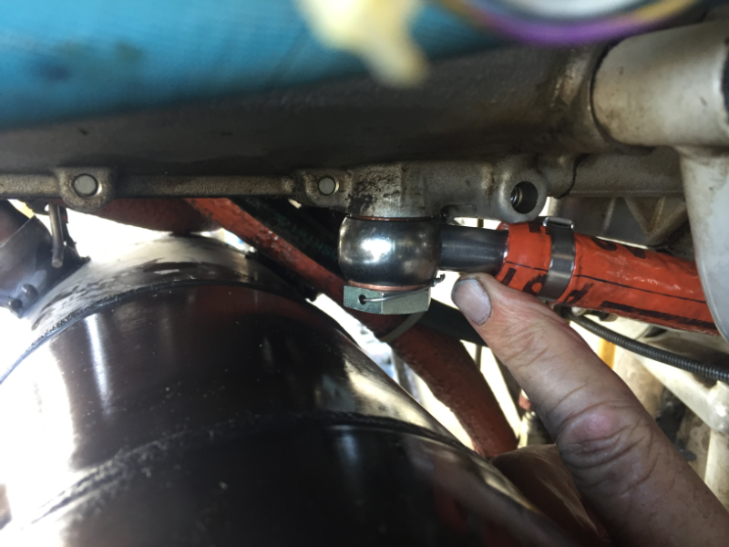

I disagree with this assessment...
I changed oil return line 4 years ago on my early SN 120058 and used banjo fitting to gain much needed clearance to the muffler. Hose routing was not a problem.

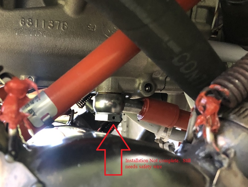

Jim has one of the early setups we did with a banjo return fitting. In order to minimize the profile even more, we now utilize a banjo fitting that is integrated directly into the hose itself. It has a slight downward bend in it which allows it to clear the case of the engine. Pictured below is the new setup in standard firesleeve.
Pictured below is the new setup in integral firesleeve which gives an equal amount or slightly more clearance on the engine case.
IF the hose is installed upside down (with the bend up and toward the case) then there would likely be an interference issue.
As Jim showed in the pictures in his post, the increase in clearance is pretty significant between the 90 degree elbow and the banjo fitting. The 90 degree elbow being used absolutely works, but a low profile elbow is required and there is minimum clearance on the exhaust.
As always, if anyone is installing any of our hose kits and has any questions during the installation, or runs into any issues, please feel free to reach out directly via email or phone to Tom or I and we will work with you to get it figured out.

Steve,
I bought my oil hoses a year ago, and the banjo fitting is straight which causes my interference. So I rotated the hose about 20-30 degrees off centerline which allowed use.

I guess we have a different opinion on what is significant clearance increase.
Per my photos in post #22 above: Stock elbow fitting is almost touching muffler. Banjo fitting has almost 1/2" clearance to the muffler. Now that is significant in anyone's book. Don't need to be rocket scientist to figure that out...

Steve,
Thanks for posting. I checked my banjo fitting today, and I did indeed install it upside down. Can’t believe I missed that. I know what I’ll be doing tomorrow.
Rich
Steve,
Rich
Rich,
No problem at all. Glad the pictures helped. We are always a phone call or email away if anyone runs into any issues with an installation or has any questions!
Happy building, (and flying)
Steve
Jim, Steve,
Thanks for this discussion about the lower oil hose. I checked to see if my fitting was inverted. Worse than inverted I have the old elbow and it is extremely close to the muffler.
As long as the elbow doesn't touch the muffler, does it matter if it is close?
Yeah, it does. Suppose on next flight one of the exhaust springs lets loose and muffler shifts position and then begins to rub on elbow. Perhaps even wears a hole in the elbow and a fire starts. See where I'm going here...?
