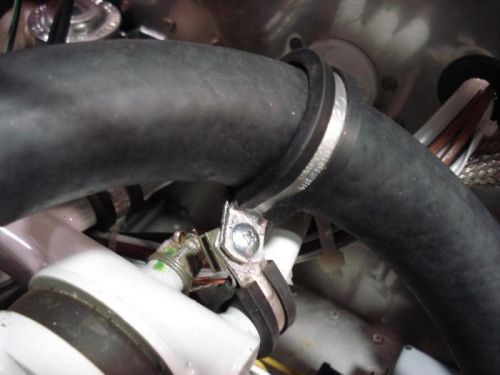

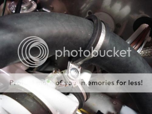

An Alternative Solution
After some discussion with John Peck, I added two Adel clamps, a year ago or so (back to back), after observing some chafing.
When I built my 12 I used RTV on all the potential chafe points. It's standard practice so I'm surprised the plans didn't just include a general statement to look for chafe points on all hoses and wires.
Did the same
Seems like the E-LSA must have a higher standard to comply with. This is a very common issue on all aviation engines.
But it is a great reminder for everyone. The nice thing with the E-LSA I guess is that we all will have the same problem where most E-AB's are different.
There are many places on my IO-540 that have the same issue with the same prevention technique.

Apparently there is a Rotax requirement to replace all rubber hoses on all 912 equipped SLSA planes after 5 years in service. Don't know if it applies to ELSA's or not. A local SLSA equipped with 912 met this requirement and the hoses were replaced. $800? The trouble was that in the process a black tie wrap was used to secure one of the radiator hoses. It melted during flight and let the hose contact the exhaust pipe which melted thru dumping the coolant. Luckily when the temperature alarms went off it happened near the airport. Be sure to use clamps as shown by Marty's photograph!
