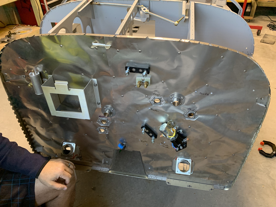

After reading several threads/posts on adding a safety margin to the firewall, I've decided that this is one of the very few modifications I'd like to make on my RV-14. However, I'm still a bit confused. I'm planning on using Fiberfrax and Dan H's method on the firewall. Dan has been kind enough to give very detailed drawings of his method. However, I'm slow enough that I'm not quite understanding when or how to mount things to the firewall.
If we put the Fiberfrax and covering on first, it appears that items on the firewall would have a very "soft" mount. If we put items on the firewall before the Fiberfrax is installed, then we could/will have hot spots in the event of a fire. In a perfect world, I'd like to install install the Fiberfrax first and then mount everything to the firewall, I'm just afraid that they won't stay put. I've cheated and put Dan's pictures and a couple other examples below.
In what order do I install the items on the firewall, before or after Fiberfrax?

Found this on Steevo's web site. It's an example of the type of items I'm wondering about.
