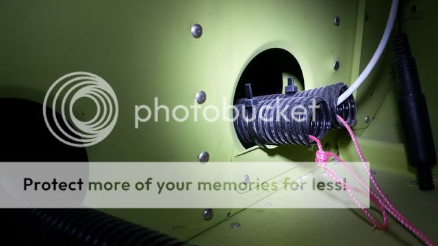

I had no trouble pulling strings and then wires through this conduit (I used Van's black corrugated). For the pull strings, a shop vac on one end of the conduit will easily suck a string to the other side. I then tied the string to end of the wire along with another piece of string and pulled both the wire and new string to the other side and repeated as necessary. I would also cover the end of the wire where I tied on the pull string with some duct tape as the bare wire had a tendency to catch on the corrugations, especially on the turns once the conduit started filling up.
Is it ok to leave the conduit in the holes like I have it? Does it need to be secured with a zip-tie or adel clamp? Not trying to be lazy, but don't wanna overthink it either
They are 1 inch each, and fit tight.
Definitely secure them or use caterpillar grommet in the lightening holes. Those edges could chew through the grommet and into your wire bundles with vibration.

Went look at HD/Lowes and couldn't find anything there that would protect the conduit. Had some gorilla tape, so I put that around the edges of the conduit.
I'd rather use grommets but those holes are pretty big... I'll look into caterpillar grommets online. Any suggestions on how to neatly secure the 2 tubes that are exiting the one hole? Tried searching but I can't find any pics of how others have done it. There are pics of 3/4 inch tubes , but not 1 inch.
You could simply cover that lightening hole with a piece of aluminum, drill 2 holes to accommodate the conduit and have a secure and neat exit for those conduits.
That may be the cleanest way to accomplish what I'm trying. The 2 conduits are TIGHT in the lightening hole. I'd have to open it up to allow space between the two tubes, which I don't really want to do.
I could cut the conduit just short of the tailcone and use a bracket as mentioned, along with a nut (silver one like I did in the rear seat) to secure it.
I was trying to find a Y to combine both 1 inch conduits into a bigger conduit (1.5inch maybe) and feed that one conduit out of the lightening hole.

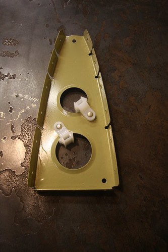

One more option to not leave the conduits just hanging in the holes is Panduit LHMS-S5-C (available here at mouser.com).
This picture from mouser(.org) shows them:
I'm using those with success, though riveting them is a bit tricky (the rivet expands a bit inside the plastic).
