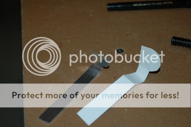

Sounds like this is the line I need to use. That'll give the fairing just a tad downward angle too, so it's not a rain funnel.
I just built some temp L-brackts that are bent to match the angle made by the trailing edge and the rivet line.

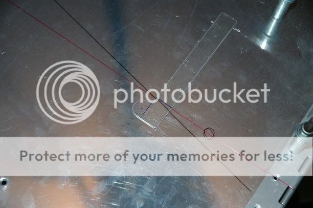

Here's my highly scientific method to find that angle. The red line is perpendicular to the trailing edge and the black line is parallel to the rivet lines in the stiffeners.
Then I bent them 90 degrees along the angle-line.
I clamped it into position and gave it a test run, but there's too much slop when it rotates.
Obviously, I'm trying to find a creative way to keep the servo parallel to the rivet line and then fairing will follow suite. I'm not a big fan of having the fairing and push rod coming out at different angles. It's just an aesthetics thing I have.
No success yet, but I'm still thinking on it.
