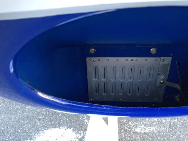

I like that oil cooler baffle. Is it your design ?. Where can I learn a little more about it ? I have an RV-12 in Seattle, and lately I could use a little more oil temp, as well as a warmer cabin.

Agreed, George... I was surprised at how little of the oil cooler I needed to block off to get the desired oil temps when flying with temperatures in the low 20s at ground level. Less than an inch.

Thx for very helpful pics of oil shutter install. I am about to do the same for new 12 in Colo where we also get cold.
Can you add info about how you mounted cable in cockpit?
