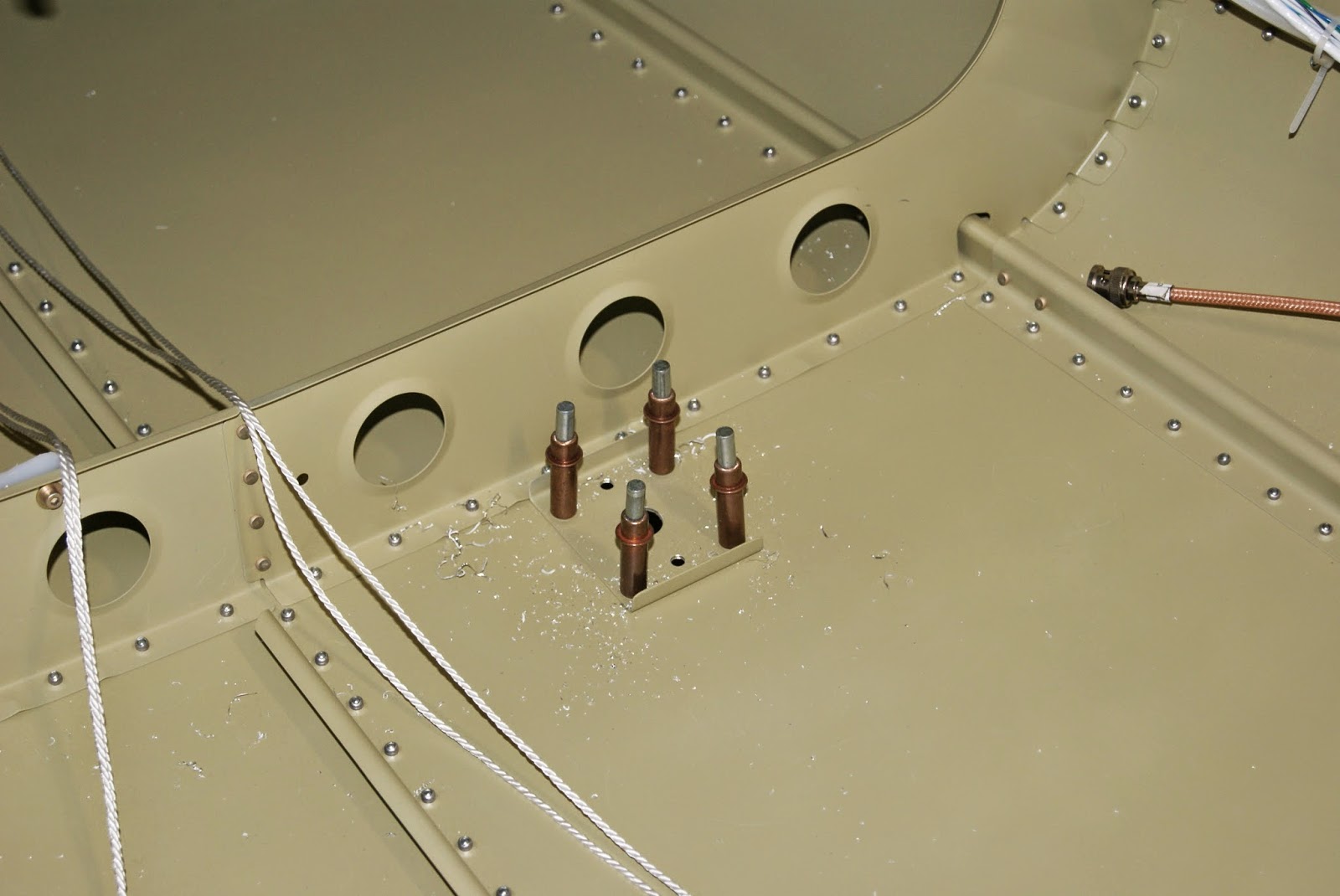

Does anyone have an avionics kit (or finish kit, whichever is appropriate) not yet installed, or have their plane apart? I would like to know the length (within a foot or so) of the coax cables for the COM and transponder antennas. I will be adding ADS-B antennas to the belly of my -12, it's not here at the moment to get measurements and I'd like to get some cable ordered.

I believe the com, transponder & ADS-B cables are now being included in the finishing kit and not as a part of the avionics package ... so you need to reach out to those who have just received a finishing kit.
I ordered ADS-B and ended up with an extra cable because it was also included in my finish kit. So I can measure the length of the ADS-B cable for you when I get to the hangar later today. Sorry can't help you with the other cable lengths because they are already installed.

Here is the info on the ADS-B coax cable for the RV-12:
The length of my cable from female BNC connector to female BNC connector measures 14? 7 1/4".
The length from the band that needs to be positioned at the grommet in the instrument panel base to the end of the coax that plugs into the ADS-B module is 12".
The cable numbers are as follows:
M17/128/RG400
Harbor Industries MIL/DTL/ 17 27478

Thanks, John! DO you know off hand roughly how far back from the COM and/or transponder antennas the ADS-B antenna is? I haven't seen one installed, so I'm thinking maybe it's aft of the baggage bulkhead?

Yes, you are correct the ADS-B antenna is located aft of the baggage bulkhead. The antenna utilizes a F-00020 doubler plate that is mounted just forward of the F-1208 fuselage frame ?. left of center ? and a little right of the middle of the three lightening holes on the left side of the F-1208 frame.
Here is a photo of the mounting location.
