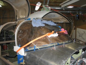

Getting ready to install the windshield tonight, and I've got quite a bit of gap on the lower/bottom corner of the windscreen frame to pull the windshield in. It pulls in easy enough with light pushing, and those 2" plastic clamps everyone uses will hold it in place easily.
Question to the group- anyone have problems with crazing/cracking using a few of those clamps and Weld-on 10? I'm pretty sure I've seen pictures with them, and I don't think tape will do the job, but wanted to make sure I wasn't setting up for failure.

I had to use a ratchet strap to pull the windshield into position to make it fit the fiberglass joggle correctly------my big concern was the gluing area is pretty small if it doesnt fit correctly.
I would be cautious of using a clamp that applies pressure to a single point.
A photo would help........
Here is a photo that shows what Mike described.

I used clamps and ended up replacing the windshield due to crazing (my biggest mistake both in terms of time and money during the build). If the clamps are being used to force the part in place, it will craze the plexiglass. The second time I used some thin aluminum to spread out the load and it eliminated the problem.

For the records, and thanks to the help here, I finished and everything came out good (at least from the fit and crazing standpoint- I did get some Weld-on on the inside of the windscreen, darn it).
Here's a shot of my set up, much like the others:
I did use a couple 2" spring clamps on the far side, but had styrofoam and a piece of fiberglass under it to spread the load.
