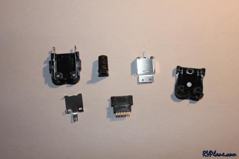

The first step was trying to identify the connector type Garmin used. I lucked out and determined it wasn't proprietary - a
Hirose 18 pin Connector. Bonus was it was readily available from Mouser.com. The Mouser part numbers for this cable are
18P CBLE PLUG STD: "ST40X-18S-CV(80)" -- $5.71
CABLE BUSHING: "ST40X-BS(4.0)" -- $0.63
So for $14 shipped, this was looking better than $65.

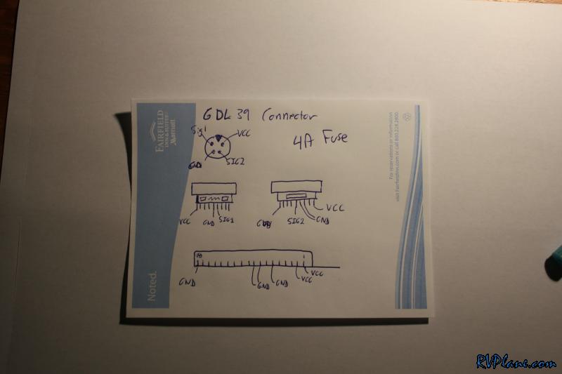

The next step was determining the pinouts. With a multimeter this was a simple task. Here are my scribbled notes.

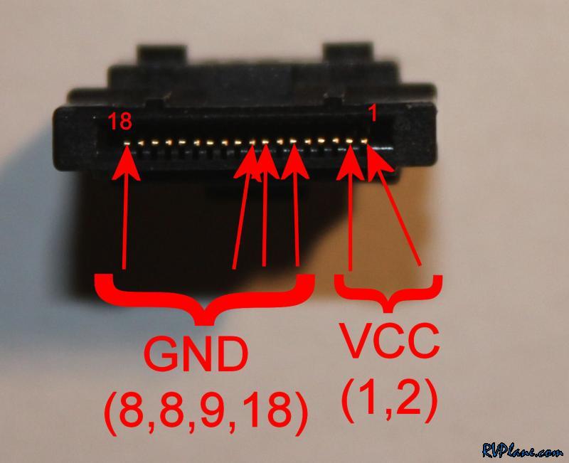

A little more detail. This is the connector side. Note the pinouts for ground should be (6,8,9,18)

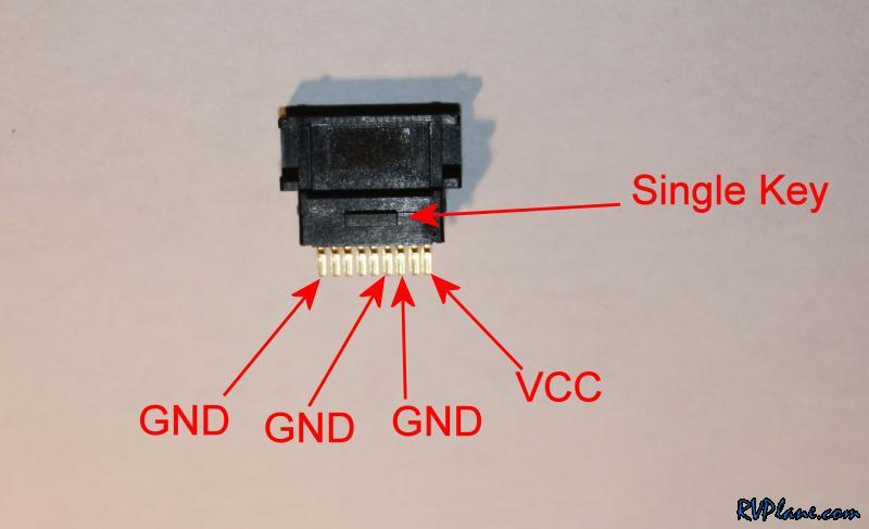

And the solder points for the "Single Key" side of the connector.

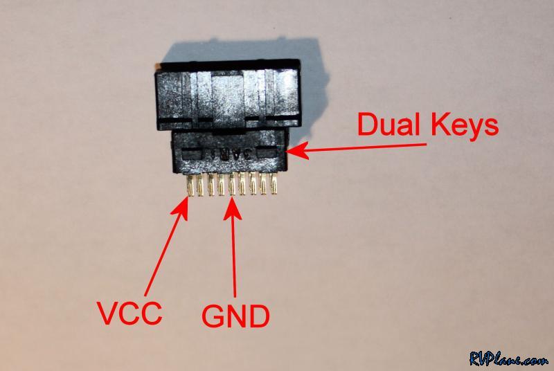

And the "Dual Keyed" side of the connector.
I wired it all up and it works flawlessly. The soldering isn't the easiest in the world since it's easy for the solder to bridge the conductors on the plug. I placed shrink wrap around each pin with a wire soldered to it because the pins tend to bend slightly. With the casing on, this seems like a solid solution. Next step is wiring it up to the RV.

In my hand-drawn pinout, the transmit and receive off of the 696 connector are located, indicated by "SIG1" and "SIG2". I don't know which one was transmit and receive, and I had no way of testing it so I didn't include something I couldn't verify into my writeup.

In one of the pics above with the numbering, it appears the text is correct (6,8,9,18) but the RED numbers on the picture show 8,8,9,18. No biggy, just wanted to clarify potential confusion. To add to what we see here in an effort to ring out some of the pins, it appears from the 696 manual and based on the orientation of the denoted pins that one can make an assumption on SIG IN and SIG OUT. I'm gonna give it the old college try at some point today. Here's the pic.

Bringing it back to life AGAIN :D I opened the factory cigarette lighter plug cable that just powers the GDL39 ( and Aera 5xx series GPS and other NUVI GPS ) and found that Garmin has 4 wires coming out for power so apparently they don't connect all of the grounds or power pins together.
I ordered a couple of the connectors today but not even their datasheet shows the pinouts, but they connect as you can see in the picture I attached:
Power: 2 end pins on each side (Single Keyed and Dual Keyed sides)
Ground: 4th pin from the power pin on the Single Keyed side and 5th pin from the power pin on the Dual Keyed side
Based on what Mike Bullock (bullojm1) and Mark Giron (MeGiron) posted, and on what I found when I opened mine I believe the Single Keyed side pins are 2,4,6,8, etc and the Dual Keyed side pins are 1,3,5,7,9, etc
SO then the Data Pairs should be:
Pin 10 Receive A
Pin 11 Txmt A
Pin 13 Receive B
Pin 14 Txmt B
