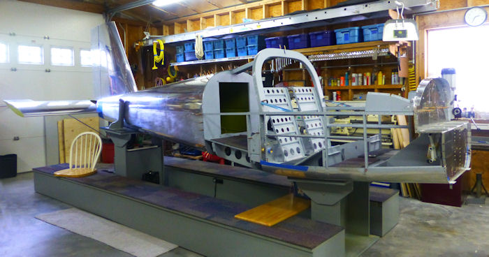

I bought all the kits at once and had the luxury of resequencing the build process when it made sense. The fuselage and finishing kits go together easier if you have everything up front and can exercise some flexibility in installation order. I would also recommend leaving the tail cone and fuselage skins off as long as possible for access.
NO Fuselage Skins
The Side Skins and the Corner Skins will be installed at a later date to allow easy access for installing all interior items.
More and more, builders are modifying the sequence to allow more access further into the build. Another thought is to NOT install the landing gear until the very last. I just HAD to get her up on the gear. Big mistake.
That's THE MOST high-tech fuselage stand I think anyone has ever built, for any of the RV's models.
Dang! That's sweet! It's even got a leg-less stool- I am guessing to be used while sitting on the floats? (errr, platforms). :)
