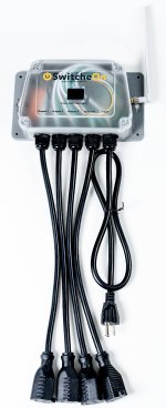

I've used Switcheon for the last three years. It's a fantastic device...simple, utterly reliable, fantastic customer service, very flexible and very cost effective. Lifetime warranty. No wifi needed, no internet, no SIM, no cellular account...only a cell connection, and because it uses IoT (therefore low bandwidth), it can be a crappy one-bar connection. It has remote thermocouple monitoring. The device is $250, and the cell connection is $50/year, first year free. It uses a simple and very effective app, which allows flexible programming to allow turning it on/off at specific times. I can't recommend it highly enough.
https://switcheon.com/power-switch/
They have a couple of other very useful and innovative remote devices as well.

Sure...just plug it in. My unit is mounted on the hangar wall next to an outlet. The switch is plugged into the outlet, and my Reiff heater is plugged into the switch. For reference, my Reiff preheater draws 600 watts/5 amps. The AntiSplat heater draws 250 watts/2.1 amps.
The Switcheon comes in three versions...a two, four, or six output switch. I need only the two-output version...use one to remotely switch my 600 watt Reiff, and the other one switches my 700 watt/6.5 amp Hornet 45 cockpit heater. The Switcheon runs them both just fine. The Switcheon output is limited to 15 amps, which I discovered when I unwisely plugged in my electric snowblower into my 3-year old unit. That overload did blow the Switcheon. I contacted them, confessed my stupidity, and they said no problem...they fix them for free.

I have the 2 circuit Switcheon. One runs my smart battery charger thru a pigtail quick disconnect accessible thru the oil access door. One runs my engine pre-heater. Works flawlessly for a year now using my Verizon cell phone. I live 1.2 hour drive from the airport & my RV6 is ready to fly when I arrive.
For clarification, I would note that the Switcheon is completely unrelated to the cell phone you use or the carrier that your cell phone plan is with. It uses its own cell connection .... LTE-M and NB-IoT bands deployed as part of 5G rollouts. The app is available for both iOS and android.

I use it to turn on my Antisplat oil heater, battery charger, and second 4" box heater that goes into the plenum. It works great. I dont get cell service at the hangar so this really saved the day.
My only suggestion is to get two of the 2 plug units if you have 2 circuits in your hangar. That way you can get more wattage in the two 15 amp units than in one. The 4 plug unit I got is still 15 amps.

Update on Switcheon
I posted about the Switcheon earlier. I have had it for a year now and it has worked perfectly. Well except when I knocker if off my cart and broke the antenna off. I sent an email and was told to ship it back and they would fix it. I offered to pay but there was no charge for the repair. They had to re solder the connection to the board back on so it wasn’t an easy fix.
I have several friends who have purchased it and all are happy they have a way to control electrical outlets with no cell service.

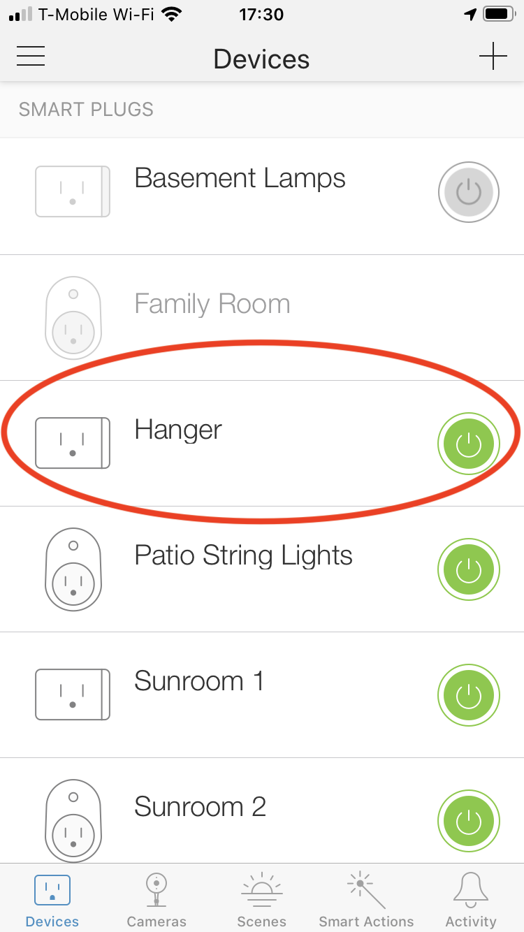

I've been using more/less the same solution outline below. This will allow you much more control and options for controlling remote devices. A simple Kasa $10 WiFi Smart Outlet paired with your Wifi Hotspot will do the job for pretty much anything you want to turn on remotely. I use it for the engine heater, hangar heater and battery charger.
I added an addition data line to my AT&T phone plan (similar to adding a iPad) and coupled that with a Netgear Nighthawk MR1100 creating a WIFI Hotspot at the hangar.
The Hotspot links to a BN-LINK Heavy Duty Smart Plug Outlet controlling a 200 watt Reiff heater. The BN Link app has real time data showing the current drain in Watts, the Voltage, and KWH for the month. An additional WIFI thermostat and app indicates the temperature in the hangar.
Testing has shown a 15 degree temperature rise per hour over ambient on the oil temp gauge but with the sensor located near the upper case it is much more because the oil temp climbs to 100+ degrees as soon as the engine is started. (Three hour heater period with engine cover / blanket)
The monthly cost is more than a text only plan but the system offers flexibility allowing all the WIFI accessories . In the non heating season I plan to use the Netgear device for camping. Last year I was camped near a guy that pulled a Hotspot up about 30 feet in a tree and had great WIFI coverage at his camping site.
