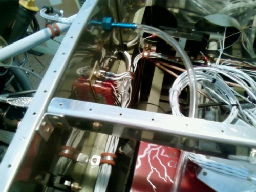

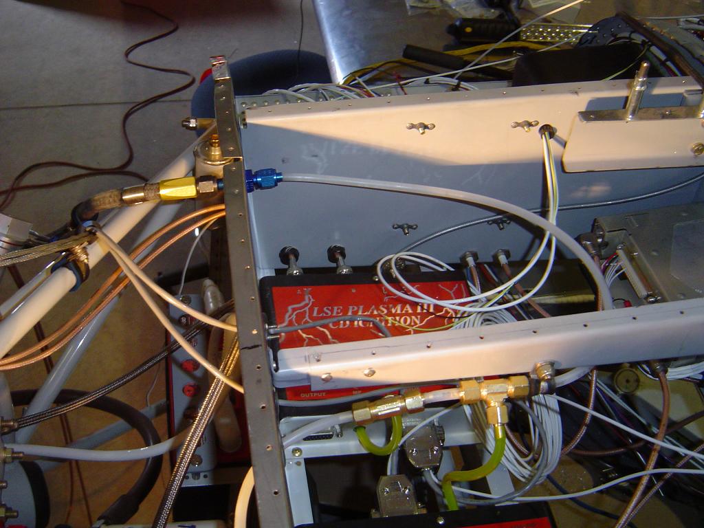

In my instance there will be a Dynon EMS and a set of LAZAR mags run off of my MP pressure source. This picture shows what I've done to solve the problem. In the end end I use only a few parts supplied by Van. That Aluminum tube isn't necessarily the way it will end up but is a good start.
I did almost the same thing-------used a bulkhead "T" with a short piece of 1/4" aluminum tube over toward the Lazar box, mounted on firewall, final connection there with an inch or so of hose.
I used the barbed mini tube fitting inside the boot cowl, screwed into the bulkhead "T", MP sensor for the GRT mounted on a rib, and about 6" of tube to connect it.

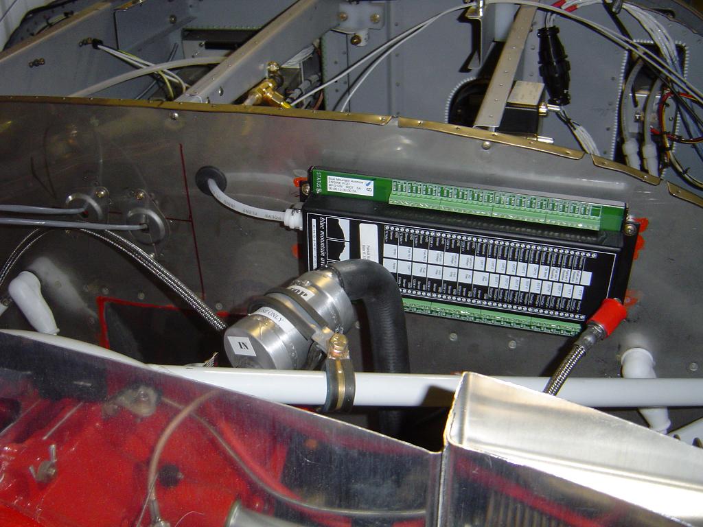

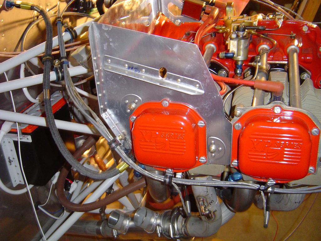

Yep. Interesting this came up when it did; I did mine today. Here's my nekkid cat:
This is Van's fitting on the cylinder and his hose to a standard bulkhead fitting. Dunno why the engine looks orange; it's really red. Must be a camera flash effect.

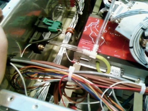

Ok, here's the meat of it. Leftover pitot line flared on aft side of firewall curves around to "tee" compression fitting. By the way, I tried normal 1/4" line (the kind used for refrigerator drains, etc.) from Home Depot and I could not tighten the fitting enough to keep the tube in place. Whatever tubing you use, test it. My pitot/static tubing came with my wing kit a dozen years ago; no guarantee that the stuff Van's ships now is the same. Anyway, mine will destroy the tube before pulling out of the fitting. I continue to the next "tee" with the same material, and then through the firewall to connect to the Blue Mountain Engine Pod.
The connections to the Lightspeed ECI boxes are with the supplied Tygon line. This stuff was a real bear to get into the compression fitting and is equally difficult to get out. I found that putting enough through the nut to be flush with the open end and then pressing the insert back into the tube worked best; the tube and seated insert would be slightly inside the nut and I could just get the nut started on the fitting. Tightening the nut pressed the insert and tubing back into place. Then the tubing was cut to length and pressed over the barb fittings in the ECI boxes.
There's the final connection; an oxy quick-connect into the Engine Pod. The grommet at the firewall will get a shield. No the braided line is not really connected to the Pod; it's the fuel pressure line, capped and awaiting hookup to it's transducer. Anyway, hopefully this will be the most complex MP setup anyone will have to deal with.
