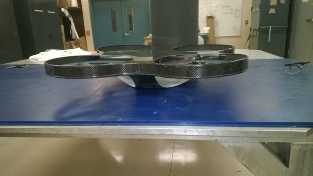

*Just my two cents, I am not an expert, I do not claim to be an expert but I do work for the Institute of Applied Aerospace Research at Middle Georgia State College working on/making things like this-
http://areai.aero/?page_id=160
and this-
Im with you guys on this one. Carbon fiber is great so long as you understand the material. Wheel pants, wing tips and especially the cowling would be awsome. I recently made up a Sam James sub cowl out of standard glass (granted Im not great at this)...but...My friend Noe Ramirez took it from me and remade the same part out of carbon fiber. The combination of his skill and the material produced a part that looks awesome and feels like a big potato chip. I cant help but think that a lot of weight could be saved by using this stuff. Another friend is putting together a carbon cub at the moment and I really dig the quality and weight of his composite stuff. When you can use a lot less material to get the same strength it just becomes a question of economics. It does cost more but if you already have the molds, what is the premium?
