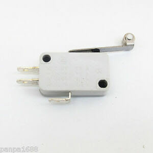

I used a military grade roller lever switch to sense the carb heat actuator position.

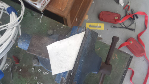

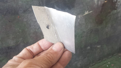

I made a mounting bracket by bending a piece of spare stainless steel. I drilled and tapped the bracket so I could use #6 screws to hold the roller lever switch to the bracket. Then I drilled a hole for a #8 screw to hold the assembly on the carb heat box.

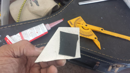

To dampen vibrations felt by the switch I bonded a piece of spare rubber to the bracket with high heat silicone sealant.

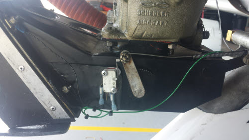

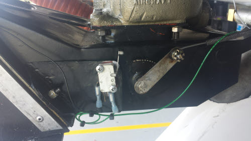

The carb heat box already had a convenient mounting location so I used a #8 screw to mount the new assembly near the carb heat actuator. By adjusting the assembly a little, when I move the carb heat knob the carb heat actuator moves the roller lever on the switch.
Carb heat OFF:
![c52a.jpg](/proxy.php?image=http%3A%2F%2Fwww.puertoricoflyer.com%2Fwpimages%2Fc52a.jpg&hash=67f38b0b7d978e11980d974cf9359b6a)
Carb heat ON:
![751d.jpg](/proxy.php?image=http%3A%2F%2Fwww.puertoricoflyer.com%2Fwpimages%2F751d.jpg&hash=9078ae66baefe2e43581b7251d30e160)
