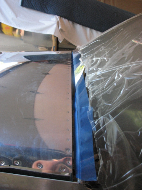

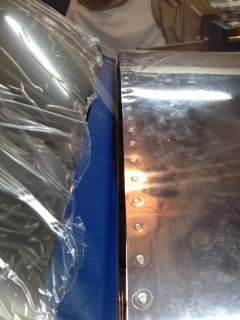

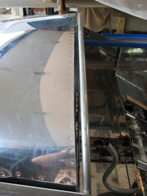

Here are some pics for you. To answer the questions: the front bow clears the instrument panel comfortably and did not require any tweaking. It measures to spec 7/16" and didn't require any manipulation. The Roll Bar assembled without any complications. The Canopy frame (inside face) is being held 1 7/32" by the 4 wooden blocks in the kit (I didn't use the correct dimension the first time:roll eyes:.)
As you can see, the canopy does extend over the roll bar, but only about 1/4". I'm worried that I'm too close to the edge to place rivets without cracking or having a wedge break (two cracks in a "V" that allow a portion of the plexiglass to just break off.)

Lateral View of Front Bow and Instrument Panel
Lateral View of Front Bow, front of Canopy and Instrument Panel
In this particular shot, the Canopy is not exactly square. When squared off, it measures 5/8" from the edge of the top cover in 3 places.
The front edge of the canopy doesn't extend right to the edge of the panel and from memory 1/2" short sounds about right. Otherwise the canopy edge will catch on the panel as you open the canopy. I'm not sure where you're measuring the 1/4" from. Is it from the contact point of the canopy on the front bow or from the front `edge' of the canopy bow?
After flying today in my RV-12, I measured the distance of my forward canopy edge to the centerline of the rivets that secure the canopy to the forward bow. On my canopy, the dims are: @ 5/8" at the left and right ends and @ 3/4" at the center of the bow. I did not have to adjust the canopy latch hole when originally fitting the canopy.

I might have figured out part of the issue. I went out to measure my plane to see how far away I am from DHeal's numbers. With the canopy firmly clamped at the spec'ed 1 7/32", my front edge of the canopy is only 1/4" away from the contact line visible on the masking tape, which is pretty far away from DHeal's ~3/4".
To answer rgmwa's question, the 1/4" that I'm looking for is called out in Fig 2 p 34-03 rev 2.
With my son helping hold the canopy from falling off, we unclamped the roll bar and did some pivot testing. My canopy just barely clears the front edge of the instrument panel. When we put everything back down, viola! the front edge is now at the specified 1/4" and there's about 3/4" of overhang in front of the bow. In short, it looks perfect.
Apparently perfect fit! Or is it :confused:...
