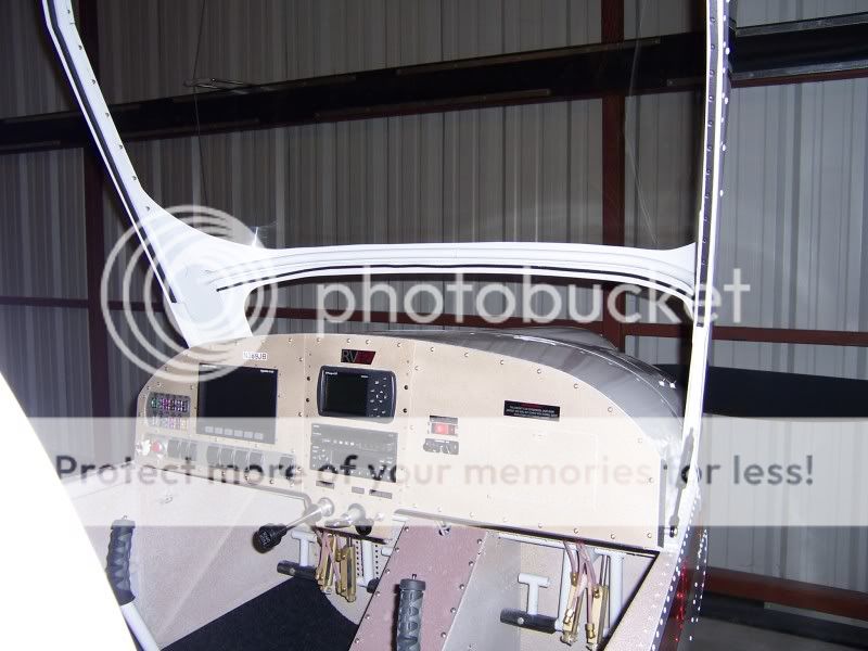

Early Seals - -
This was my first sealing. The ones on the sides have worked very well. I think they were 3/8" thick foam type weather strips. You can see the rivet impressions on the one. I have changed the others to things that work better. You need fairly thick ones on the side of the dash. 1/2" I think. Most recently, I have put a double wide 1/8" thick white rubber seal across the top of the dash. Does not migrate, and seals well, but you have to keep the canopy closed and partially latched all the time to compress them, or they will make closing the canopy difficult. Just a habit you need to do. In Iowa in the winter, you get the seals to work, or freeze ! :D

I did like John & John did. Brought home several types from ACE and experimented. I could not get the black hard foam applied on the rails to compress enough easily to close the canopy so used the softer gray kind shown in the picture. The black stuff worked well on the sides of the panel where a LOT of air came in.
I have not applied a seal across the top of the panel, there is a small amount of air coming in there but temps are mostly mild in WA and I don't mind this small amount of ventilation.
