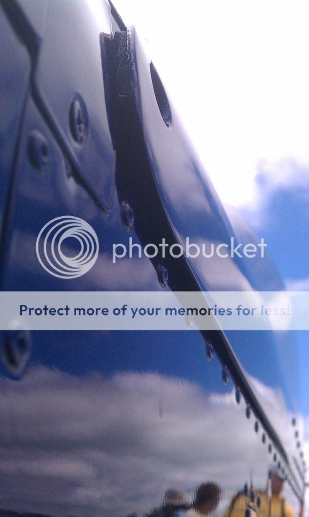

Factory built RV12 canopy
As said before, without pics we really can't know exactly what you are seeing.
So I would say just add the washer and you will be fine. As you can see in this pic of a factory built RV 12 they easily have 1/4inch clearance on the front of their canopy and that gap gets smaller as you go aft.;)

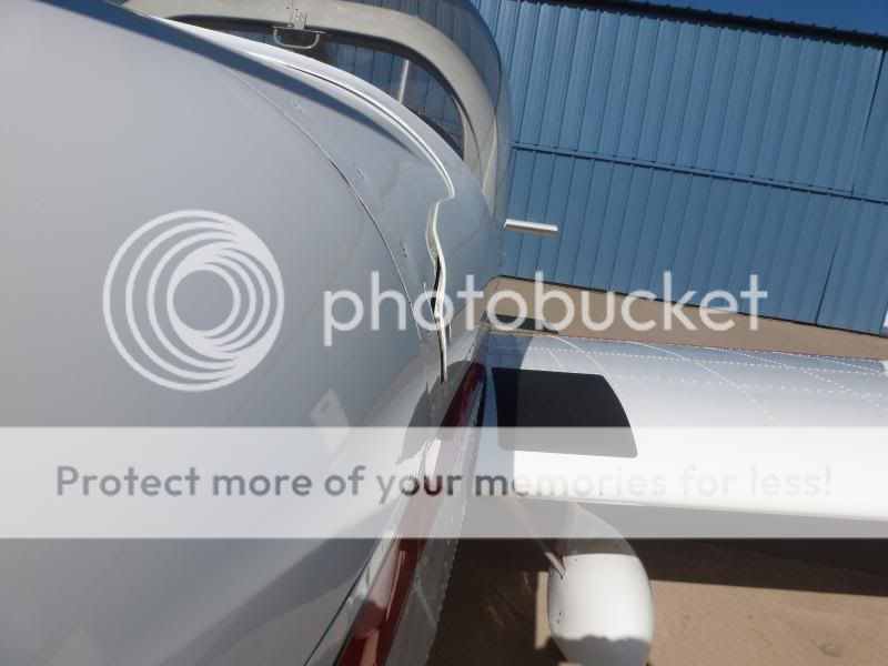

My canopy fit - -
I have ONE fairly thick washer behind the hinge each side. Rounded corners fairly well. No problems.
