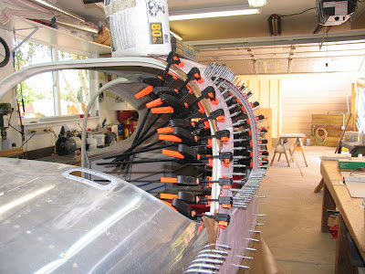

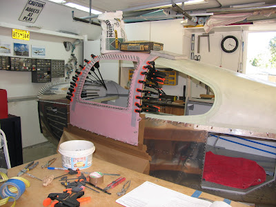

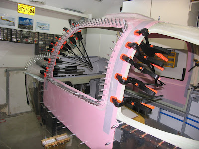

post some pics
Pat,
post some pics when you have an opportunity so we can more clearly see
where your problems are.
My doors needed a bit of persuasion too before they fell in line.
Notice the concrete bags on top?
Maybe you can use these pics to point out the problems.
The last pic is for motivation only.

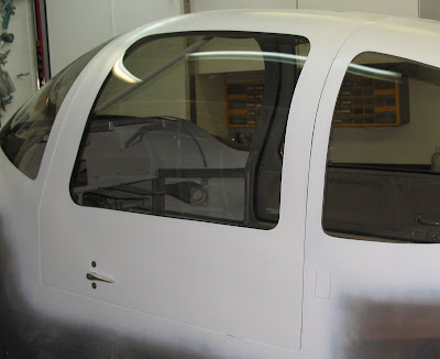

Door
Ernst<
What is the white colored product, pin hole filler or primer. Also thanks for the pictures, it looks great.
Pat
white primer filler
Pat,
Glad to see your problem solved.
The white stuff is Loehle primer filler from Loehle aircraft.
