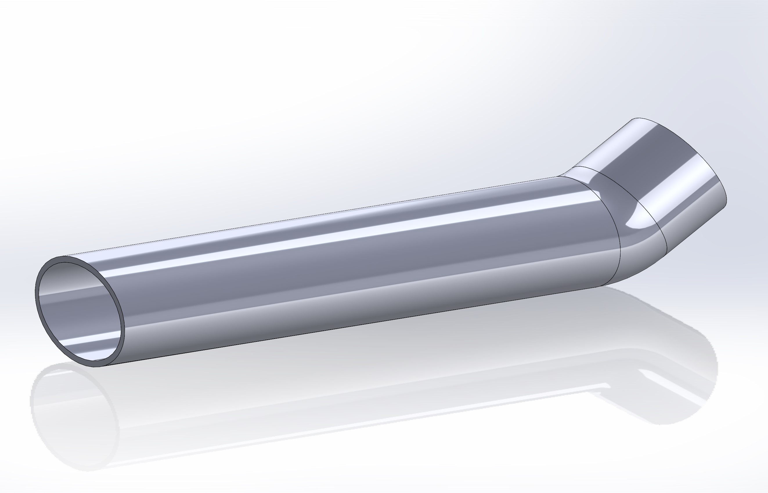

I am new to CAD, I’m sure I’m making this difficult. What I’m trying to create is a 2” pipe squished to an oval, 6” long, then bent at 30° for 2”. Can anyone help me?

There are several ways to interpret what you want. Can you at least attach a hand-drawn sketch?

You're leaving off some variables, but something like this? Really easy to do...draw an ellipse on a plane and then draw a line on a plane perpendicular to that one which defines the path you'll sweep it along. Search YouTube for Swept Solid or Swept Boss.
Full disclosure it was on my friends computer I dont know the software he had. We were able to print a oval tube like I wanted but thats it, no bend. I wanted a lip on the edge as well so the clamp to have something to grab on to but we never made it that far. No surprise I am full on noob and need direction how to do this so I dont have to rely on others. He and I bought the printer together I just need to figure out how to design what I need.
Maybe like this?
Is this kind of what you're after?

Yes perfect,

These are the dimensions I would think with the lip would be this dimension and the rest smaller. I’d love to learn how you did this.

I modeled this with NX but don’t know what you are using. Usually the terminology is similar between systems. Mark is right on, youtube search terms like sweep, extrude, and revolve. If you can’t get it i can send you a teams invite and i’ll share my screen
