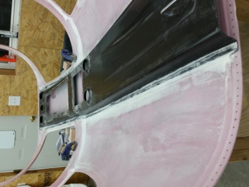

The Aerosport overhead console is finally mounted on the cabin top and I'm starting to work on the cabin top cosmetics and overhead to cabin top transition.
For those who have kept the carbon fiber look, how have you made the transition from carbon fiber overhead to paint on the cabin top above and around the door opening? I'm struggling with how to make the transition along the shadow line of the overhead console look good and not have a ridge of paint or overhead clear coat.
Any advise would be appreciated.
In the photo below, the shadow line will be the bottom edge of the green fine line tape. I'll sand the clear coat between the green tape and the raw carbon fiber/ flox blend line. I'm planning to put a single piece of thin fiberglass tape over the transition and then micro to near the shadow line. Sand smooth, fill, paint. But that transition from the actual shadow line to the paint has me perplexed. I'm planning to use a single stage PPG product for paint so no clear coat on the paint.
Thanks for your help!
