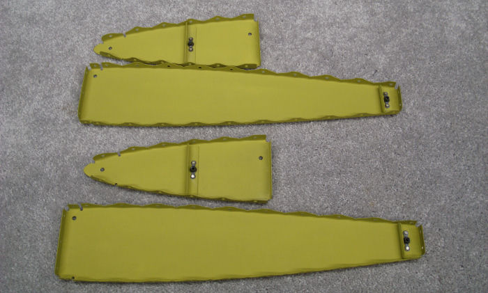

Building EAB Stab Fairings
Added nutplates to Stabilator for adding removable Fairings.
These nutplates can also be used to add flags or small turn signals for towing
To add nutplates is a concern as it may require you to go EAB?
